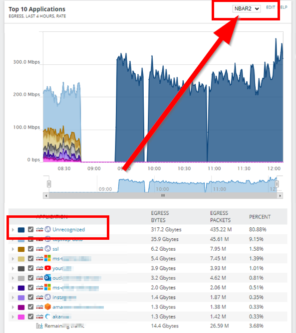

NTA application traffic for Cisco ASR/ISR devices shows as "Unrecognized" after upgrading to SolarWinds Platform 2024.1 and above
After upgrading to SolarWinds Platform 2024.1 and above, NTA application traffic for Cisco ASR/ISR devices shows as unrecognized. Prior to 2024.1 and below, this issue did not occur.
When Devices Cisco ASR/ISR series device exports flow templates + data (flow data) with observation id = 256 but options templated + data (NBAR2 labels) with observation ID = 6 that is different.

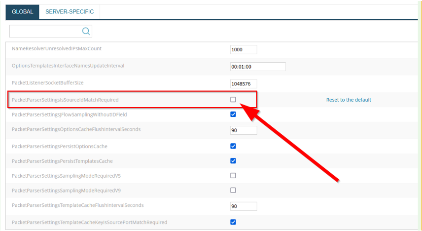

the setting "PacketParserSettingsIsSourceIdMatchRequired" was changed to True
We can change back to false by going to advanced settings
- Login to SolarWinds Platform web console
- Navigate to https://<Orion_URL>/orion/Admin/AdvancedConfiguration/Global.aspx
- Under advanced configuration change setting for NetFlow.Processing, search for PacketParserSettingsIsSourceIdMatchRequired
- Uncheck the setting (FALSE)
