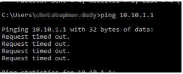

  1. RDP to the server from which the node is being polled.
  2. Ping the node IP from this server:Ping the node IP from this server
  3. If the node does not reply, the network admin must investigate why the node is not responding to ICMP from the server it is being polled from.
