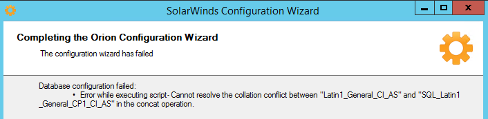

NPM Configuration Wizard fails as it Cannot resolve the SQL collation conflict in the concat operation
What to do if The configuration wizard fails with the following error: Database Configuration failed: Error while executing script - Cannot resolve the collation conflict between "Latin1_General_CI_AS" and "SQL_Latin1_General_CP1_CI_AS" in the concat operation.
4/29/2019 5:38 PM
10/2/2022 3:04 AM
While upgrading your server:
  • From: NPM12.0 / SAM 6.2.4 / NCM 7.5
  • To: NPM12.3 / SAM 6.7.0 / NCM 7.8
  • Database Configuration failed: Error while executing script - Cannot resolve the collation conflict between "Latin1_General_CI_AS" and "SQL_Latin1_General_CP1_CI_AS" in the concat operation.
This SQL Server is running SQL 2012 and is dedicated to SolarWinds.
  • I have checked and the SQL Database is using the "SQL_Latin1_General_CP1_CI_AS Collation" (As recommended)
  • The SQL Server Instance is using the "Latin1_General_CI_AS" collation.
  • Is there a way to easily change the collation without impacting the database itself?
Network Performance Monitor
The SQL Instance Collation doesn't match the Orion DB Collation.
  • As a result, the TempDB and Model DB in the SQL Instance also have the incorrect Collation.

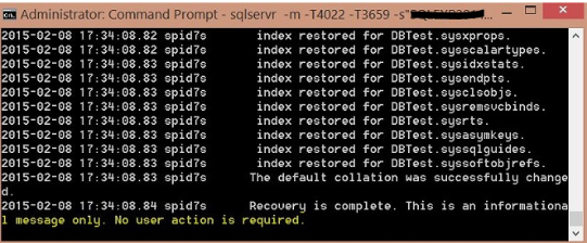

To edit the SQL Server Instance Collation.
  • If need to edit the SQL Instance Collation, you will need to stop the SQL Server Instance.
    (You can use Services.msc, cmd or SQL Mgmt Studio to do this)
    • NET STOP "MSSQLServer"
  • Execute the command below.
  • A lot of information will appear and no user action is required, just close the prompt window after the execution ends.
  • The parameter "-s" is only necessary if more than one SQL Server instance exists on the target machine.
    • sqlservr -m -T4022 -T3659 -s"MSSQLServer" -q"SQL_Latin1_General_CP1_CI_AI"
    • (Screenshot property of © 2020 Microsoft)
  • Parameters used:
    • [-m] single user admin mode
    • [-T] trace flag turned on at startup
    • [-s] SQL server instance name
    • [-q] new collation to be applied
