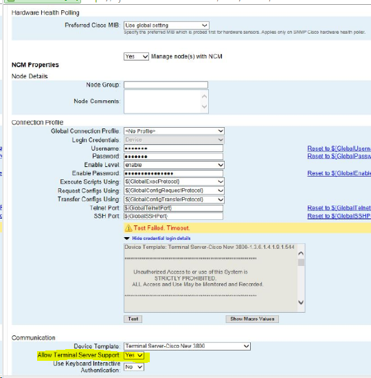

This article provides information on and steps to resolve the issue when you have a number of Cisco devices for which you are unable to download the configurations.
This worked before the upgrade to the latest version, but no longer does. The devices are menu based with 99 used to enter the CLI mode. The template does not recognize the menu and therefore does not enter the 99 selection to exit the menu and then enter enable mode. Using the Interactive wizard does not give the option for menu based devices.

Network Configuration Manager
You have enabled Allow Terminal Server Support to YES causing the issue within the device response.
Disable Allow Terminal Server Support to NO and then try to connect
Also use the below template for the device in question
<Configuration-Management Device="Cisco 3845 New" SystemOID="1.3.6.1.4.1.9.1.544">
                <Commands>
                                <Command Name="RESET" Value="terminal width 0${CRLF}terminal length 0"/>
                                <Command Name="Reboot" Value="reload${CRLF}y${CRLF}y"/>
                                <Command Name="EnterConfigMode" Value="config terminal"/>
                                <Command Name="ExitConfigMode" Value="end"/>
                                <Command Name="Startup" Value="startup"/>
                                <Command Name="Running" Value="running"/>
                                <Command Name="DownloadConfig" Value="Show ${ConfigType}"/>
                                <Command Name="UploadConfig" Value="${EnterConfigMode}${CRLF}${ConfigText}${CRLF}${ExitConfigMode}"/>
                                <Command Name="DownloadConfigIndirect" Value="copy ${ConfigType} ${TransferProtocol}://${StorageAddress}/${StorageFilename}${CRLF}${CRLF}${CRLF}"/>
                                <Command Name="UploadConfigIndirect" Value="copy ${TransferProtocol}://${StorageAddress}/${StorageFilename} ${ConfigType}${CRLF}${CRLF}"/>
                                <Command Name="DownloadConfigIndirectSCP" Value="copy ${ConfigType} ${TransferProtocol}://${SCPServerUserName}@${SCPStorageAddress}/${StorageFilename}${CRLF}${CRLF}${CRLF}${CRLF}${SCPServerPassword}"/>
                                <Command Name="UploadConfigIndirectSCP" Value="copy ${TransferProtocol}://${SCPServerUserName}@${SCPStorageAddress}/${StorageFilename} ${ConfigType}${CRLF}${CRLF}${SCPServerPassword}"/>
                                <Command Name="EraseConfig" Value="write erase${CRLF}Y"/>
                                <Command Name="SaveConfig" Value="write memory"/>
                                <Command Name="FreezeLoginForPreCommand" Value="True"/>
                                <Command Name="PreCommand" Value="99"/>
                </Commands>
</Configuration-Management>
