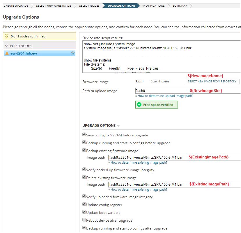

Why does NCM need this?
Information about the existing image path is used by NCM to pre-populate a TextBox field with the appropriate path when one of the following upgrade options are selected:
  • Delete existing firmware image
  • Backup existing firmware image
The same path used for the old image will be automatically pre-populated in the “Path to upload image” field on the Upgrade Options page.
Additionally, this information is used by the Free Space Detector when NCM is trying to evaluate if there is enough room available on the device to upload the new image. If NCM detects that there is not enough free space, it will try to determine if deleting the existing image will free up enough space to proceed.
What if this command is not specified?
This command is optional. If the user does not specify this command in the template, it will cause the following:
  • If the user decides to delete the existing firmware image during the upgrade, they will need to manually specify the path to it on the Upgrade Options page.
  • If the user decides to back up the firmware image during the upgrade, they will need to manually specify the path to it on the Upgrade Options page.
  • NCM's Free Space Detector will not be able to automatically determine if there is enough room to upload the new firmware image.

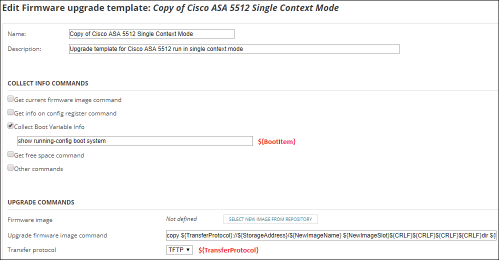

Collect Boot Variable Info
This command was added in NCM V 7.7 to support firmware upgrades for Cisco ASA devices. There is a significant difference between a Cisco ASA and a Cisco IOS device when updating the boot variable (which image to load after reboot). The Cisco ASA must remove all existing boot paths (send a “no” command for each existing boot path it has (there may be more than one). This command will collect all existing device boot paths, and store the results into the ${BootItem} macro for use during the run of the Update Boot Variable command (which is described later in this document).
NCM needs this command to support updating the boot variable on Cisco ASA devices. NCM does not need this for any other model.
This command is used only for Cisco ASA devices.
If it is not specified, it will be not possible to run a firmware upgrade on a Cisco ASA device.

The following is an example of this command for non-Nexus devices:
copy ${TransferProtocol}://${StorageAddress}/${NewImageName} ${NewImageSlot}${CRLF}${CRLF}dir ${NewImageSlot} ${SuccessRegEx:${NewImageName}}
For Cisco Nexus devices, the command copies multiple images. The image name macro specifies the type of image (shown in bold in the example below):
copy ${TransferProtocol}://${StorageAddress}/${System.FileName} ${NewImageSlot} vrf management${CRLF}${CRLF}${CRLF}${CRLF}dir ${NewImageSlot} ${SuccessRegEx:${System.FileName}}${CRLF}copy ${TransferProtocol}://${StorageAddress}/${Kickstart.FileName} ${NewImageSlot} vrf management${CRLF}${CRLF}${CRLF}${CRLF}dir ${NewImageSlot} ${SuccessRegEx:${Kickstart.FileName}}
Before you customize this command, it is important to understand the macros used in the command. Some of these macros must be present in the command body of any template, but others are optional:
${TransferProtocol} – Will be parsed to specify in the template which transfer protocol to use (TFTP or SCP). This macro is optional. You can hard code the protocol name instead.
${StorageAddress} – Will be parsed to the NCM TFTP server IP address specified in NCM TFTP server settings. This macro is optional. You can hard code the IP address of the TFTP server in the command body instead.
${SCPStorageAddress} – If you choose to use the SCP protocol, use this SCP server IP address macro instead of the TFTP one. This macro is optional. You can hard code the IP address of the SCP server in the command body instead.
${SCPServerUserName} – Applicable only when SCP commands are in the template. It will be parsed to the configured SCP server user. This macro is optional. You can hard code the SCP server username in the command body instead.
${SCPServerPassword} – Applicable only when the SCP protocol is selected in the template. It will be parsed to the configured SCP server password. This macro is optional. You can hard code the SCP server password in the command body instead.
${NewImageName} – For non-Nexus devices, this macro is mandatory. NCM will parse it to the name of the firmware image that the user selected to upload to the device.
${System.FileName} – For Nexus devices, this macro is mandatory. NCM will parse it to the name of the system image that will be uploaded to the device.
${KickStart.FileName} – For Nexus devices, this macro is mandatory. NCM will parse it to the name of the kickstart image that will be uploaded to the device.
${NewImageSlot} – This macro is mandatory. NCM will parse it to the value that the user entered in the “Path to upload image” field on Upgrade Options page.

Delete firmware image command
This command is optional. If it is specified, the user will be able to select “Delete Existing Image” on the Upgrade options page. Enabling that option will execute this command during the upgrade.
Example:
delete ${ExistingImagePath}${CRLF}${CRLF}${CRLF}
Macros used:
${ExistingImagePath} – This macro is mandatory. It will be parsed to the value that the user enters in the “Image path” for the “Delete existing firmware image” option on the Upgrade Options page.
${CRLF} – As part of the delete command, a device may ask a question like “Are you sure?” several times. In response to a question like this, use this macro to send the 'Enter' command.

Cisco ASA Extension
As previously described, the Cisco ASA has special requirements to update the boot variable. It is not possible to just send the ‘no boot system’ command to delete the existing boot path and specify a new one. If multiple boot paths are in need of removal, there is a separate 'no' command for each registered path. As you remember, all existing boot paths on the device were collected by the “Collect Boot Variable Info” command into the ${BootItem} macro. To update the boot variable on a Cisco ASA device, we need to use that collected info.
Example:
config terminal[Repeat:no ${BootItem}]boot system ${NewImageSlot}${NewImageName}${CRLF}end${CRLF}write memory${CRLF}${CRLF}${CRLF}show boot ${SuccessRegEx:${NewImageName}}
The [Repeat:no ${BootItem}] construction tells NCM to repeat the command as many times as the number of values we have collected in BootItem macro.
Example:
NCM has collected the following list of boot paths:
boot system flash:/image1.bin
boot system flash:/image2.bin
As a result, NCM will parse [Repeat:no ${BootItem}] to the following lines:
No boot system flash:/image1.bin
No boot system flash:/image2.bin
The Repeat statement currently works only with the ${BootItem} macro. It will not work with any other macro. In the future, additional macros may be added for other device types if needed.

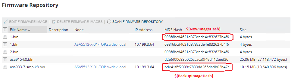

Verify uploaded firmware image integrity command
This command is optional. If it is specified, the user will be able to select the “Verify uploaded firmware image integrity” option on the Upgrade Options page. Enabling that option executes this command during the upgrade.
The purpose of this command is to verify the integrity of the image after the transfer from NCM to the device is complete. To do so, NCM calculates the MD5 hash of the image on the server-side. After that, this command is executed again to calculate the MD5 hash of the file on the device and compare it to the hash calculated on the NCM server. If the hash is equal, it means the image was transferred correctly and not corrupted.
For non-Nexus devices, the following example verifies the hash on a single image:
verify /md5 ${NewImageSlot}${NewImageName} ${NewImageHash} ${SuccessRegEx:Verified}
For Cisco Nexus devices, the following example verifies the hash on the system image and the Kickstarter image:
show file ${NewImageSlot}${System.FileName} md5sum ${SuccessRegEx:${System.Hash}}${CRLF}show file ${NewImageSlot}${Kickstart.FileName} md5sum ${SuccessRegEx:${Kickstart.Hash}}
Macros used:
${NewImageSlot} – This macro is mandatory. It is parsed to the value the user entered in the “Path to upload image” field on the Upgrade Options page.
${NewImageName} – For non-Nexus devices, this macro is mandatory. It is parsed to the name of the firmware image that the user selected to upload on the device.
${NewImageHash} – For non-Nexus devices, this macro is mandatory. It is parsed to the MD5 hash of the newly uploaded firmware image file calculated on NCM server side.
${System.FileName} – For Nexus devices, this macro is mandatory. It is parsed to the name of the system image that the user selected to upload on the device.
${System.Hash} – For Nexus devices, this macro is mandatory. It is parsed to the MD5 hash of the newly uploaded system image file calculated on NCM server side.

Macros Mapping Summary
The following images provide a summary of where macro values come from:
