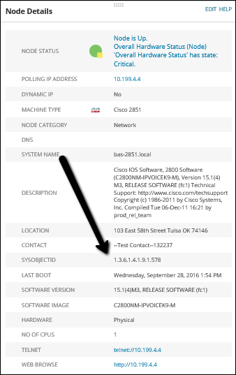

For NCM 7.4 and above the System OID can be found in the Node details in Orion. (NCM 7.0-NCM 7.3 may be in both the Web and the currently removed Win 32 client above)
This device's System OID is 1.3.6.1.4.1.9.1.516. From the list above, none of the device command templates match this OID exactly. However, the 'default' Cisco IOS device command template uses a partial SystemOID: 1.3.6.1.4.1.9. so this will match the device System OID the closest, and will be used as the device command template.
