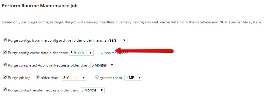

The Default Database and Archive Maintenance job is what is used to trim the NCM_CacheDiffResults table in the database.
The default is 6 months, but is routinely set to a lower value since this table can grow large quickly based on Number of Nodes, how many config types there are, how often config changes are made, and how often configs are downloaded.
Other contributing factors will include the NCM setting for how many lines are stored for before and after the change.
The key take away on this is to check the value in the job if it is running on the retention set for Purge config cache data older than line in the Default Database and Archive Maintenance job
