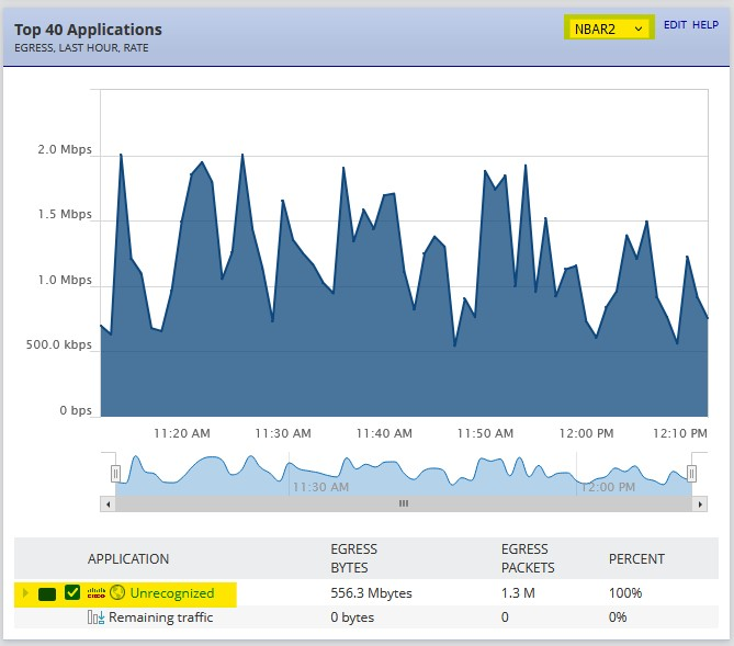

NBAR2 traffic Showing as Unrecognized
Cisco ISR4000 series routers for NBAR2 Application shows the traffic as "Unrecognized".

You can monitor NBAR2 applications by switching the view type in the top-right corner of the Top XX Applications widget or from the NetFlow Applications Summary view. For more information about monitoring applications, see Monitor NBAR2 Applications in NTA.

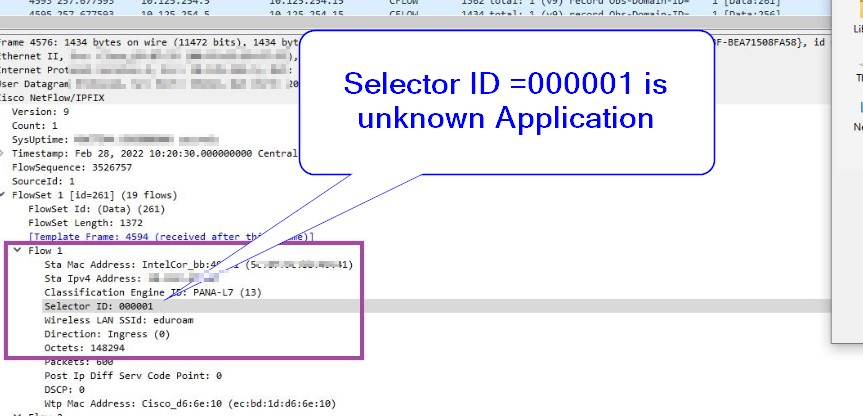

 By Default, in NTA, the applications detected are based on the Application ID that the device vendor recognizes.
This is also indicated in NBAR2 Applications

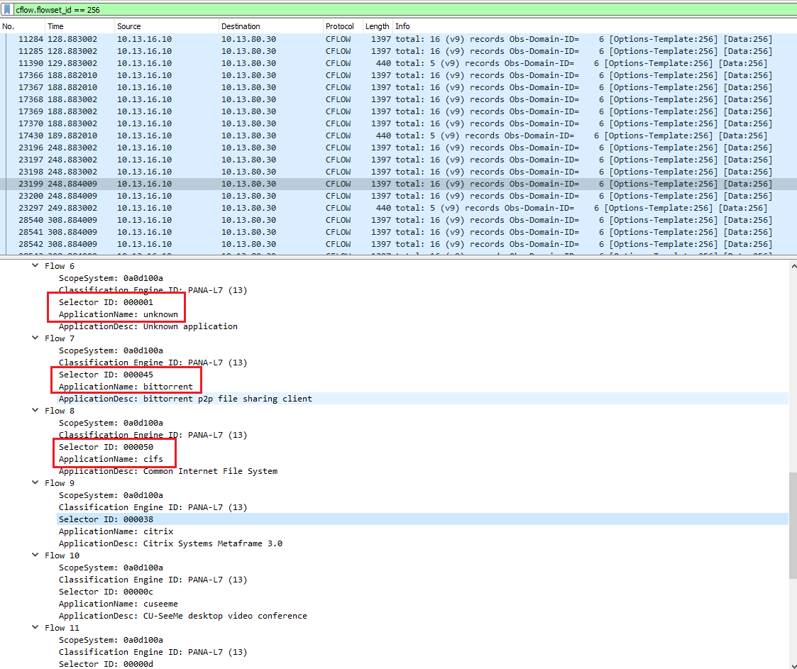

So, now verify/test if the router sends the application info correctly through a packet capture tool like Wireshark.
If the router sends the application info correctly after checking/testing for the devices through a packet capture tool like Wireshark, then check the following.

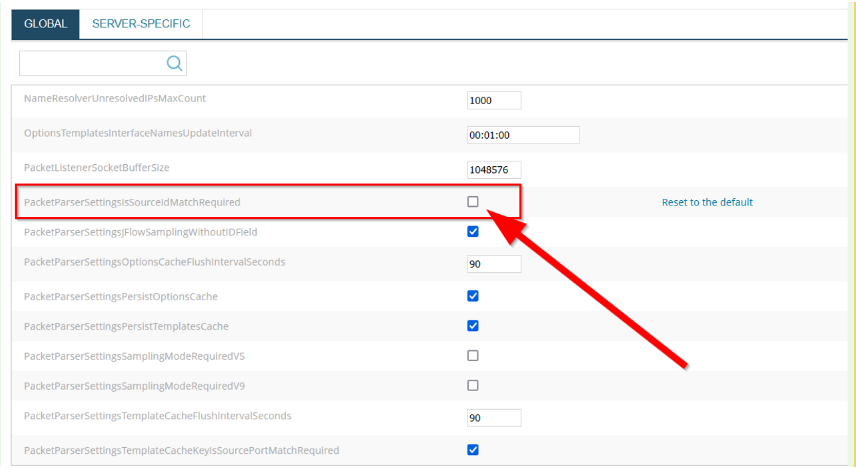

The setting "PacketParserSettingsIsSourceIdMatchRequired" might have changed to True.
We can change it  back to false by going to advanced settings:
  1. Log in to the SolarWinds Platform web console.
  2. Navigate to https://<SolarWinds_URL>/orion/Admin/AdvancedConfiguration/Global.aspx.
  3. Under advanced configuration, change the setting for NetFlow.Processing, search for PacketParserSettingsIsSourceIdMatchRequired.
  4. Uncheck the setting (FALSE) and Save the change.
