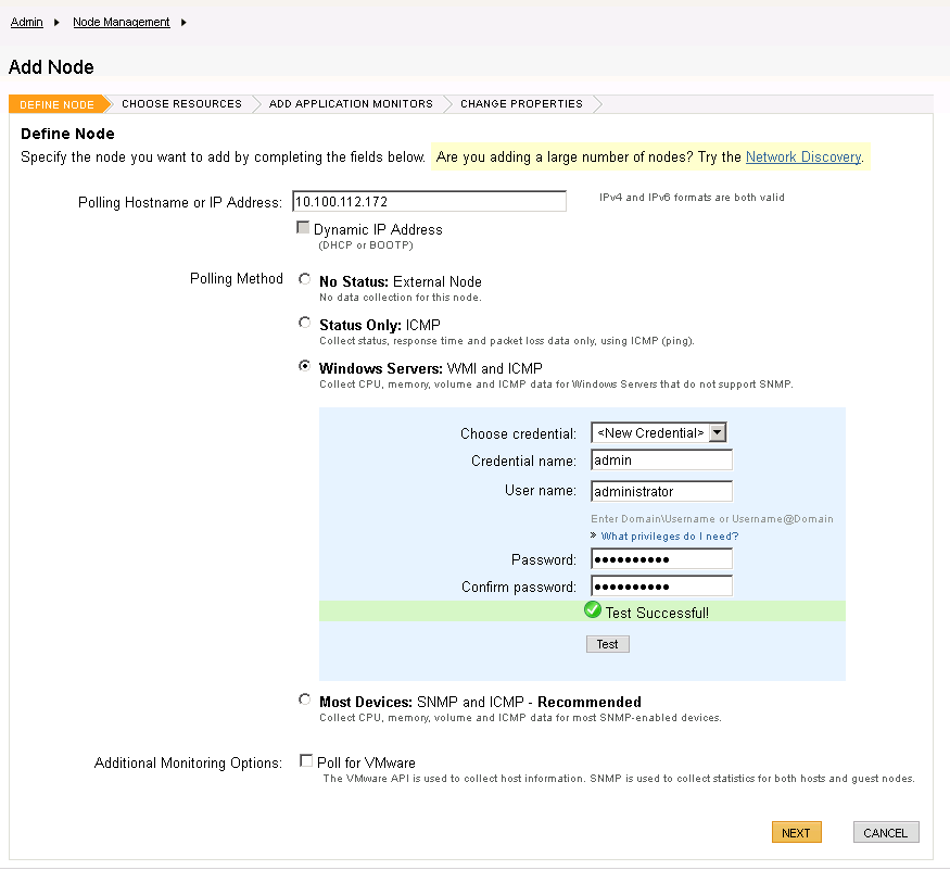

1. To monitor the WindowsMount points on the server you need to have SAM 5.5 or higher installed.
2. Monitor the node via WMI instead of SNMP.

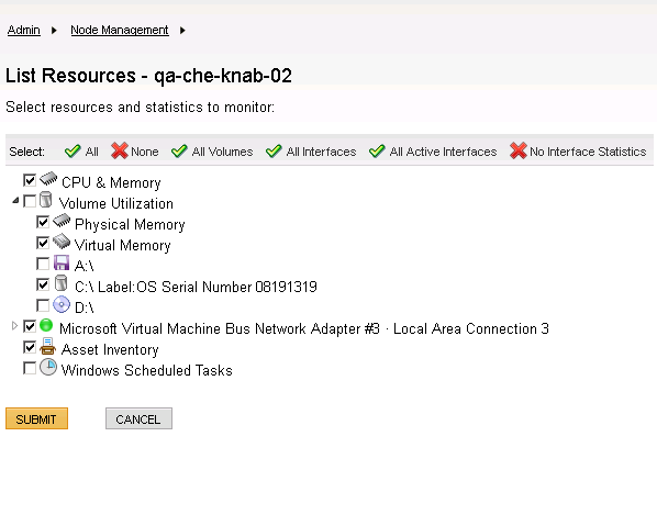

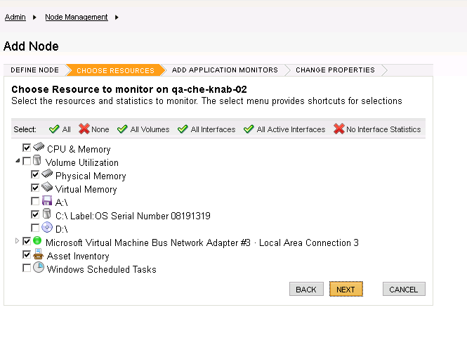

3. When the node is monitored using WMI, a list resources is done on the node.
4. Add the resources and hence Mount Points are shown as resources, which can be monitored.
