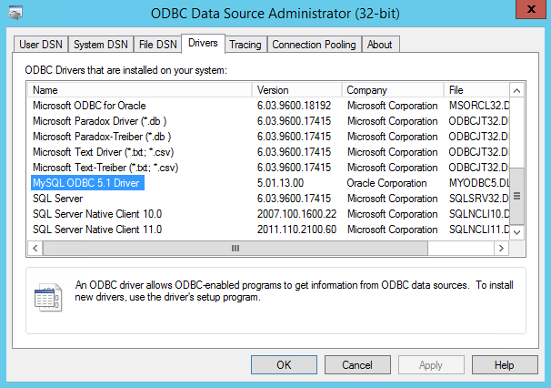

  4. Once installed, open ODBC Data Source (32-bit) and click on the Drivers tab.
    C:\windows\syswow64\odbcad32.exe shows you 32-bit drivers and
    C:\windows\system32\odbcad32.exe shows you 64-bit drivers
    Make note of the MySQL Driver name. In this screenshot,  it is MySQL ODBC 5.1 Driver. This may vary depending on the version of the MySQL driver installed.

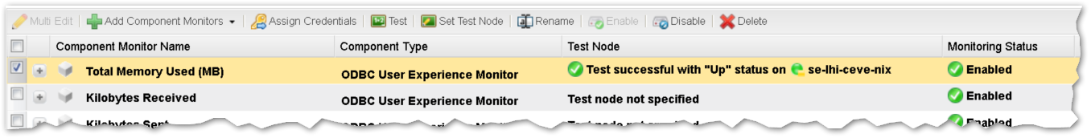

  1. Open SAM and find and edit the MySQL template.
  2. Expand the first component to test with.

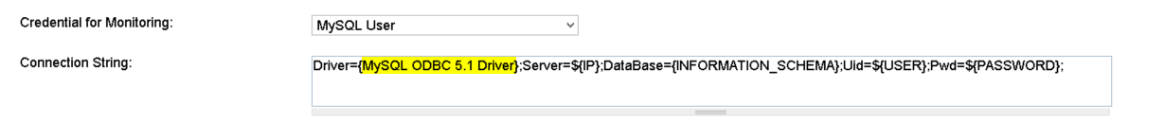

  3. Edit the Connection String and insert Driver={} with the name of the MySQL Driver you noted in step 3 of prerequisites.
  4. Make sure you define Credentials for monitoring too, those would be a MySQL user.
  5. Test the connection, as long as everything is in place, the test should be successful. If not, then click details in the error and see what it gives and where you might need to start troubleshooting.
