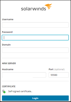

  2. Click the Start menu, navigate to the SolarWinds folder, and select ARM - Configuration Wizard.
  3. Log in using your ARM software credentials.

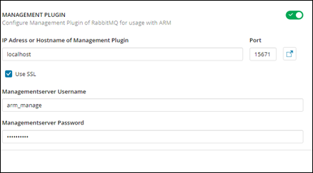

  6. Scroll down to Management Plugin.
  7. Add the new account you created in the RabbitMQ Administration Console, and then click Next.
  8. Click Save Config. The password change is completed.
