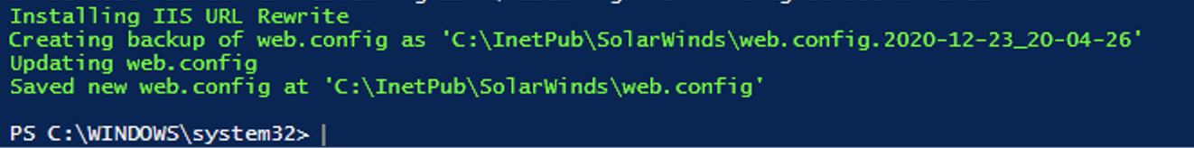

You will see script output like the following:
