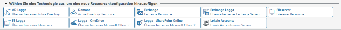

The issue is caused by a corrupted installation. There will be no errors or warnings during the installation and ARM will be installed and ready to use.
The only clue that something is wrong is that you will not see usually available scans like Teams and all other related Office365 technologies.
