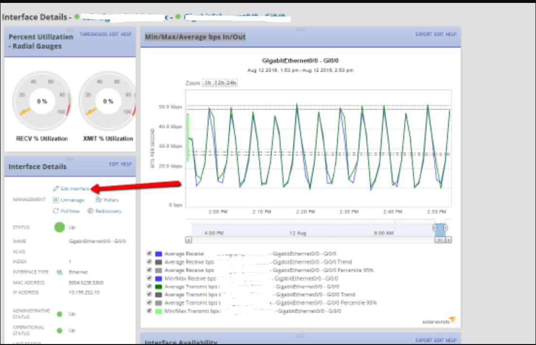

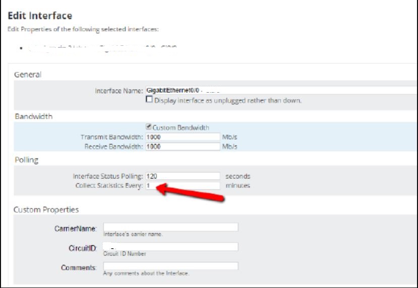

  3. Click submit and allow polling to collect data so data going forward will display in one minute intervals.
    • Note: This will increase data in the database and will affect performance. Setting this to all interfaces is not recommended, but make sure the servers have enough resources to handle the load.
