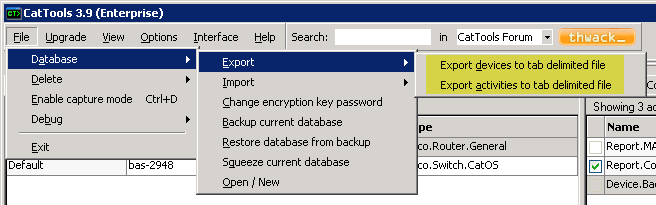

- Go to File > Database > Export. Export the devices and activities using the options highlighted in the screen shown below:
- Save the exported files which are in

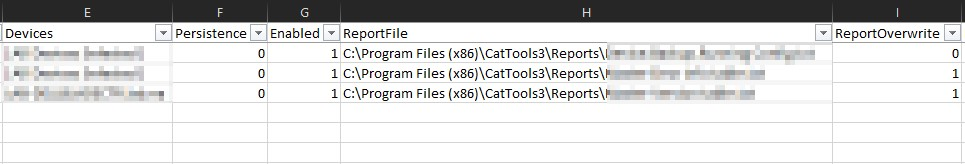

- Open the Activities file and ensure that all paths are valid. For example, if CatTools was previously installed in
c:\program files\and is now installed in c:\program files (x86)\, you will need to reflect this path change within the TXT file.- Note: You can open the exported Activites file in a edit such as Microsoft Excel and edit in a manner like a xlsx or csv file. You see see fields with file paths that you can modify to reflect your new deployment:
