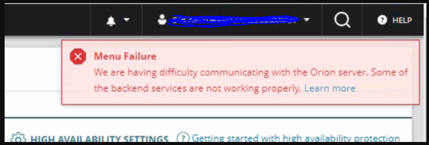

After logging into the web console, you may notice a "Menu failure: We are having difficulty communicating with the Orion server. Some of the backend services are not working properly" message, yet the menu works as expected.
After clicking on "Learn more" and scrolling to the bottom of the displayed information, you will find the SWQL query, which is timing out.
