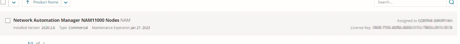

2. Go to Settings > All Settings > License manager > Check if AWS is licensed properly.
For NAM customers with NAM Gen2 Bundled license you will only see one license.
You will need to reach out to support / Customer service team to verify if the Additional Web server license is valid in the NAM bundle.
3. If the license is expired, then apply or re-apply a valid license for the additional web server.
