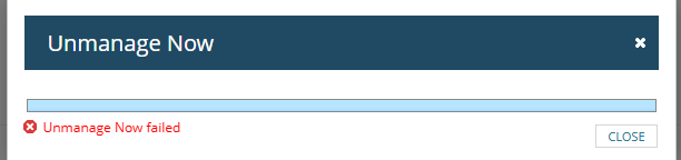

Manual mute/unmanage action fails for all nodes and users with "Unmanage now failed" and "Mute now failed" messages
Users are unable to perform manual "Mute Now" or "Unmanage Now" actions on any nodes, receiving the errors "Mute now failed" and "Unmanage now failed" respectively.

This is a known issue that can occur when a user accesses the SolarWinds web console from a remote host and there is a time synchronization discrepancy between the remote host and the primary SolarWinds Platform server. Even a small difference, where the remote server time lags behind, can cause manual "Unmanage Now" and "Mute Now" actions to fail.
Orion Platform
The issue occurs when a user accesses the SolarWinds web console from a remote workstation and there is a slight time synchronization discrepancy between the remote system and the SolarWinds Platform server.  This behavior is associated with sensitivity to timestamp differences between the client initiating the action and the SolarWinds Platform server processing it. As a result, manual mute and unmanage operations may fail when performed from remote hosts.

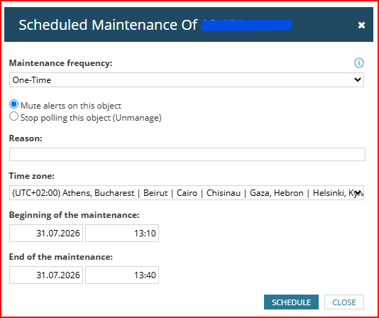

If time synchronization does not resolve the issue, use the Schedule Maintenance option instead of Unmanage Now or Mute Now. Alternatively, perform the action from the Manage Entities page.
