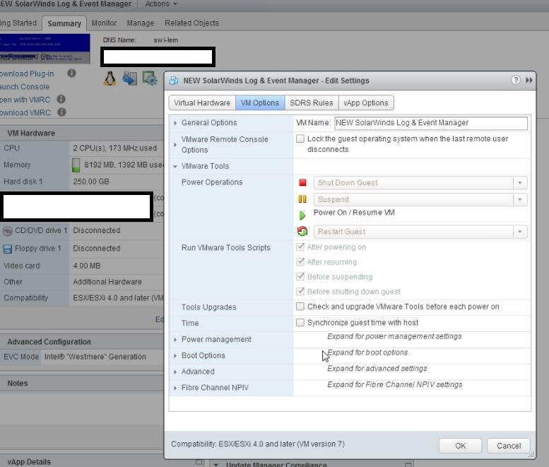

To turn off SEM time synchronization with the VMware host in order to specify NTP servers.
  1. Go to vSphere Client.
  2. Go to SEM.
  3. Click the Summary tab.
  4. Go to VM Options, and then clear the Synchronize guest time with host check box.
  5. Click OK.
