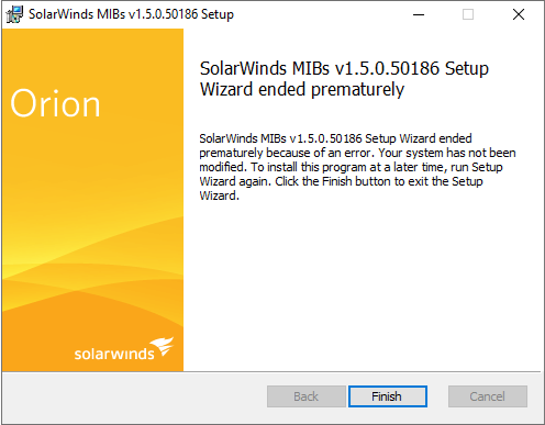

During the installation of the MIBs database update, you might encounter the following error message:
SolarWinds MIBs vx.x.x.xxxxx Setup Wizard ended prematurely because of an error. Your system has not been modified. To install this program at a later time, run Setup Wizard again. Click the Finish button to exit the Setup Wizard.

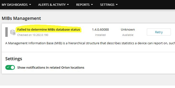

Under MIB Management, the following message appears:
Failed to determine MIBs database status when trying to update the MIBs database
