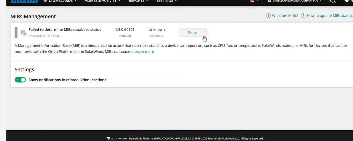

When navigating to Settings > All Settings > MIBs Management, the page displays a Retry button instead of the expected Download button. The page may also show the message:
Failed to determine MIBs database status
Clicking Retry either does nothing or continues to show the same message.
