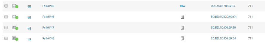

This article addresses the issue where an endpoint (MAC address) shows an unknown icon or vendor. The MAC address EC:BD:1D is identified as a Cisco device. However, it is showing as an unknown vendor on the Web Console.

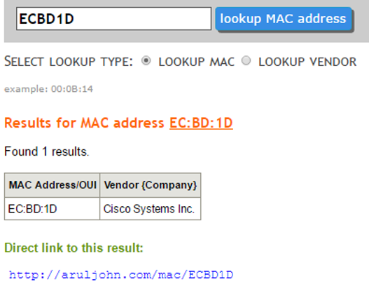

This site (© 2000 - 2017 Arul John, available at http://aruljohn.com/, obtained on May 24, 2017) shows that the MAC address EC:BD:1D is identified as a Cisco device.
