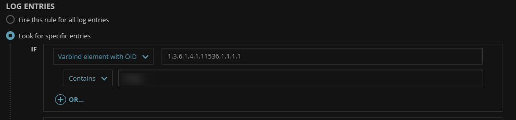

Another common issue is the use of the filter "Varbind element with name" or "Varbind element with OID."
  • Ensure that the element name is an exact match. Case sensitivity applies.
  • Using OIDs: include the parenthesis around the OID value as it appears in the incoming trap message.
    • If the OID with parenthesis did not work, try the exact OID value instead. image.png
