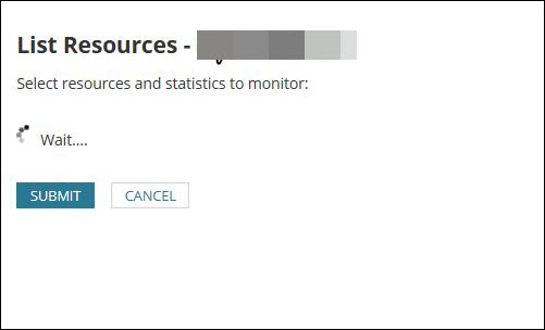

List Resources keeps spinning in the SolarWinds Platform
This article explains what needs to be done to get List Resources to return resources. List Resources keeps spinning and never returns the list of resources.
