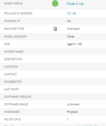

Node details are missing or displaying unknown on Linux Agent in SolarWinds Platform
Node details such as machine type, vendor, and description are missing or displaying Unknown in Nodes Details page.
2/9/2026 12:18 PM
2/9/2026 4:30 PM
On Linux nodes polled by Agent, the Node details (Machine Type/Vendor/Description) are blank or Unknown for Linux agent node.
Status / polling still works for CPU, Memory, etc., or only some metrics are missing (depending on pollers).
