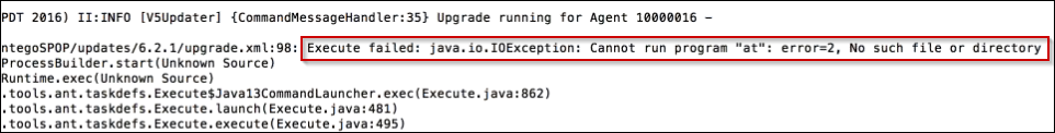

The manager.log file in the CMC shell displays the following error during the agent upgrade attempt. (To view the log file, go to Manager > Showlog.)
Execute failed: java.io.IOException: Cannot run program "at": error=2, No such file or directory
Security Event Manager
The Linux at command is not installed or was not included with your Linux distribution.
The agent upgrade process requires the at command to be installed.
