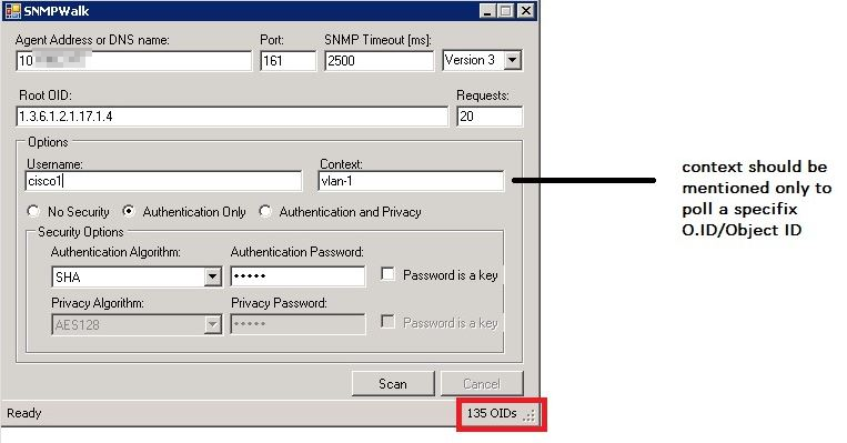

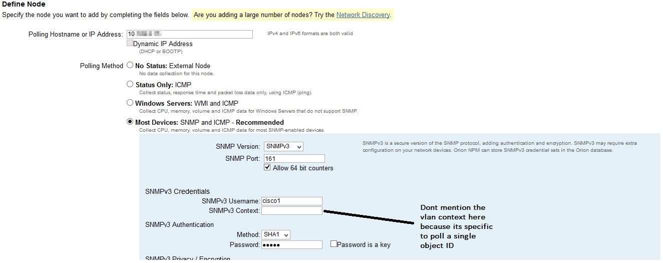

    Do not enter the VLAN context in SNMPv3 Context while adding the node in UDT. See the following screen shots for your reference.
