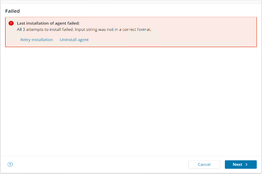

When setting up Platform Connect, you may experience the following error:
Last installation of agent failed
All 3 attempts to install failed. Input string was not in a correct format.
Retry installation    Uninstall agent
SolarWinds Observability
You may experience this error as SWOSH (formerly HCO) on the main polling engine is not able to download the UAMS Agent. This could be due to the following:
  • Certificate validation fails due to OCSP endpoints being blocked
  • Installer download fails or connection to SWO SaaS fails as the URLs are blocked
  • The anti-virus installed on the SWOSH server does not allow the UAMS Agent to be saved to the disk when downloading
