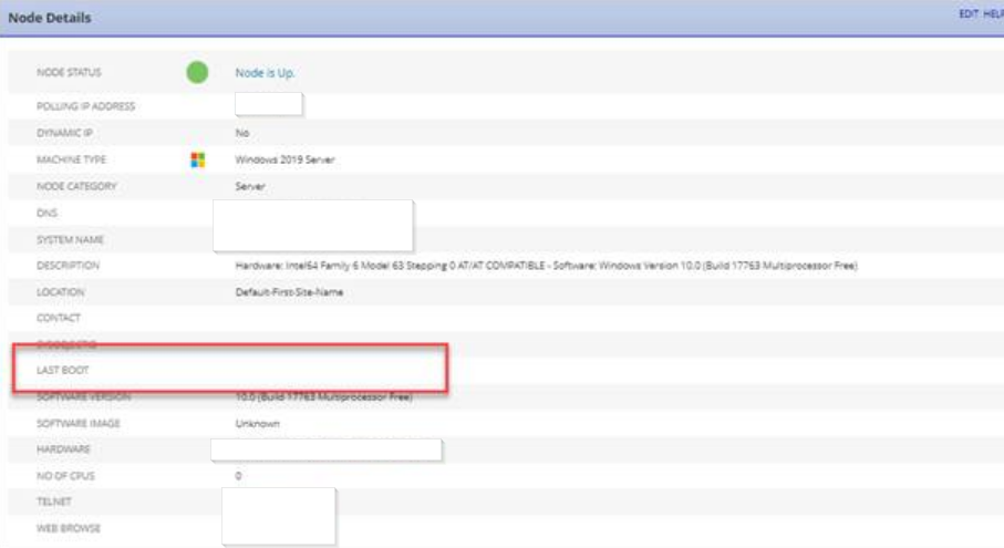

This article discusses an issue where Last Boot field is empty on the Node Details Widget for a Windows node monitored via WMI.

This article addresses an issue where the Last Boot Time for a Windows node monitored via WMI in SolarWinds appears as Null or Empty.
Orion Platform
  • The poller entry is N.Uptime.WMI.XP which is not applicable for some Windows nodes
ErrorCode=5
ErrorMessage=Cannot retrieve data from 'X.X.X.X' at namespace 'root\CIMV2'
Query: select SystemUpTime from Win32_PerfFormattedData_PerfOS_System
Querying the class using wbemtest may also return Invalid class.
