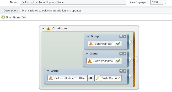

For our first attempt, we tried the following:

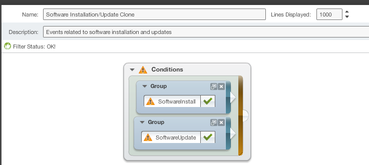

- In the default condition, we already have SoftwareUpdate Event in its own group.
Like below:

- Close (press the x) on the Group that has just the softwareupdate.toolalias not equals to Vista Security.

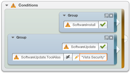

In the end you will see the following:
-Conditions: -
Group: SoftwareInstall checkmark
Group: SoftwareUpdate checkmark & SoftwareUpdate.ToolAlias Not equal To Vista Security
-End of conditions-
Like the following:
Click Save.
Check under the Monitor page, and this filter should be working.

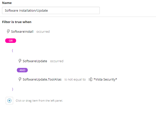

SEM HTML5 console (versions 6.6 and newer).
In the SEM Events Console, edit the Software Installation/Update filter as shown below.
Learn more about editing filters in the SEM Events Console here.
