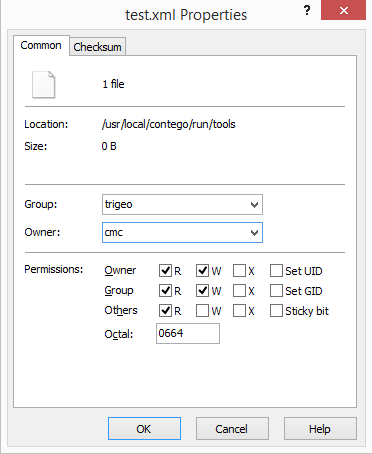

  6. Select all of these files through the winscp interface in the right panel and change the permissions by right-clicking on the selection, and then choosing Properties from the drop-down list.
  7. In the Common tab, change the Group to trigeo and the Owner to cmc, and then change the permissions in the Octal field to 0664.
