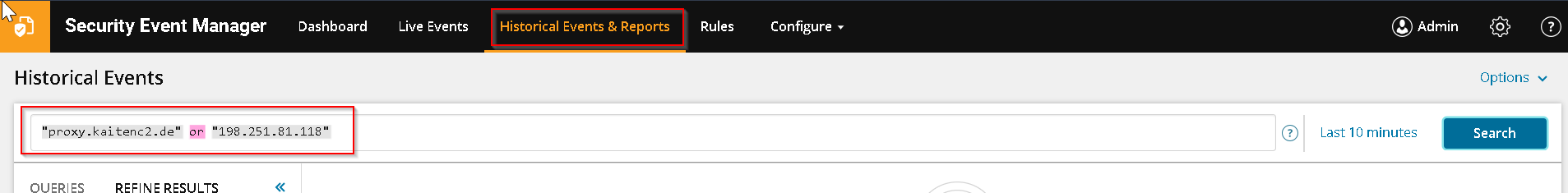

Tip:  You can use a tool like:  nslookup, dig, Resolve-DnsName, and a online DNS lookup tool like(https://mxtoolbox.com/) to get both the hostname and IP of the SIte.  You can then use this information to search the Historical Events & Reports in SEM to find which device reported the problematic site to SEM.
Example:
