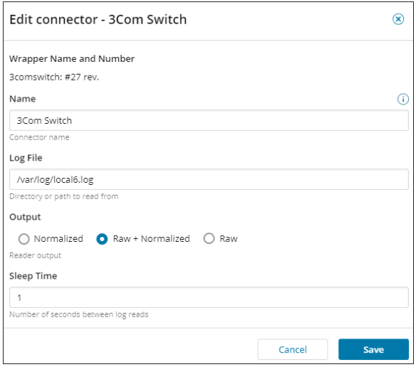

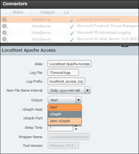

Log Forwarding on the SEM is configured on a per-connector basis by changing the Output type on the connector from Alert to Alert, nDepth.
In the HTML5 SEM Events Console, select Raw or Raw + Normalized under Output.
Because of how the FIM connector is set up, you cannot change its output type to Alert, nDepth (or Raw + Normalized). As a result, it is excluded from being used with Log Forwarding.
