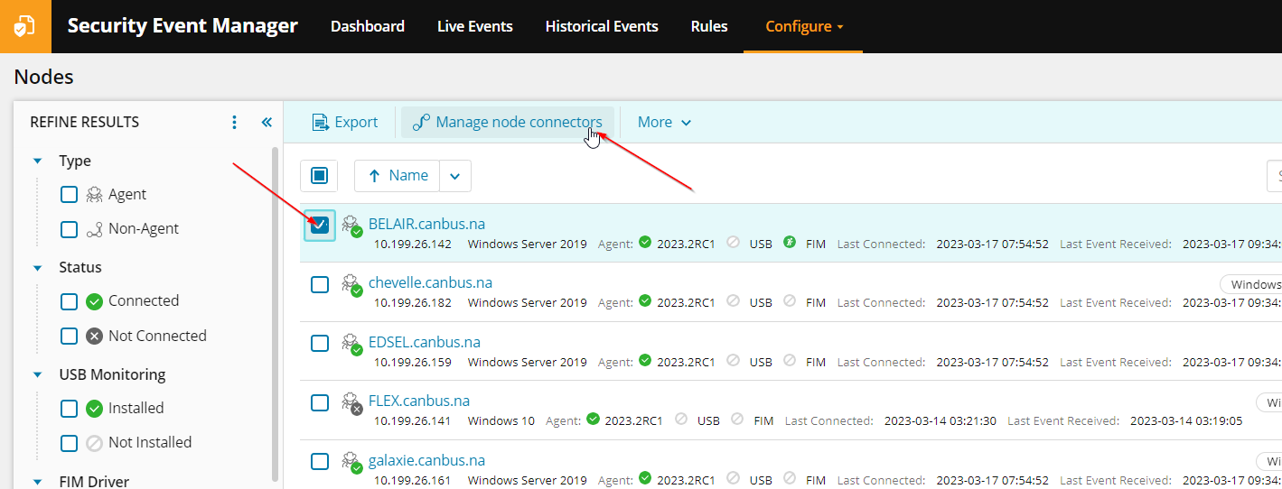

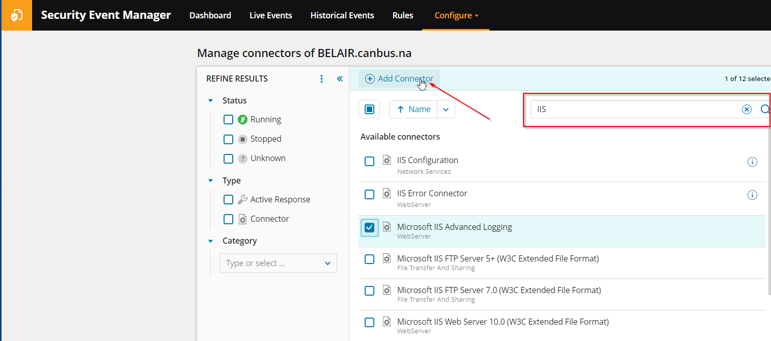

  1. Open the connectors on the node where IIS has been installed:
    Configure > Nodes > Select Node > Manage node connectors

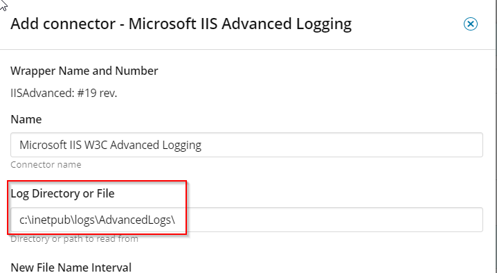

  2. Type IIS in the search bar, Find the Microsoft IIS Advanced Logging Connector, Select it and click Add Connector:
  3. Set up the IIS Advanced Logging Connector to point at the correct log file location: Make sure to review the folder path on the node.

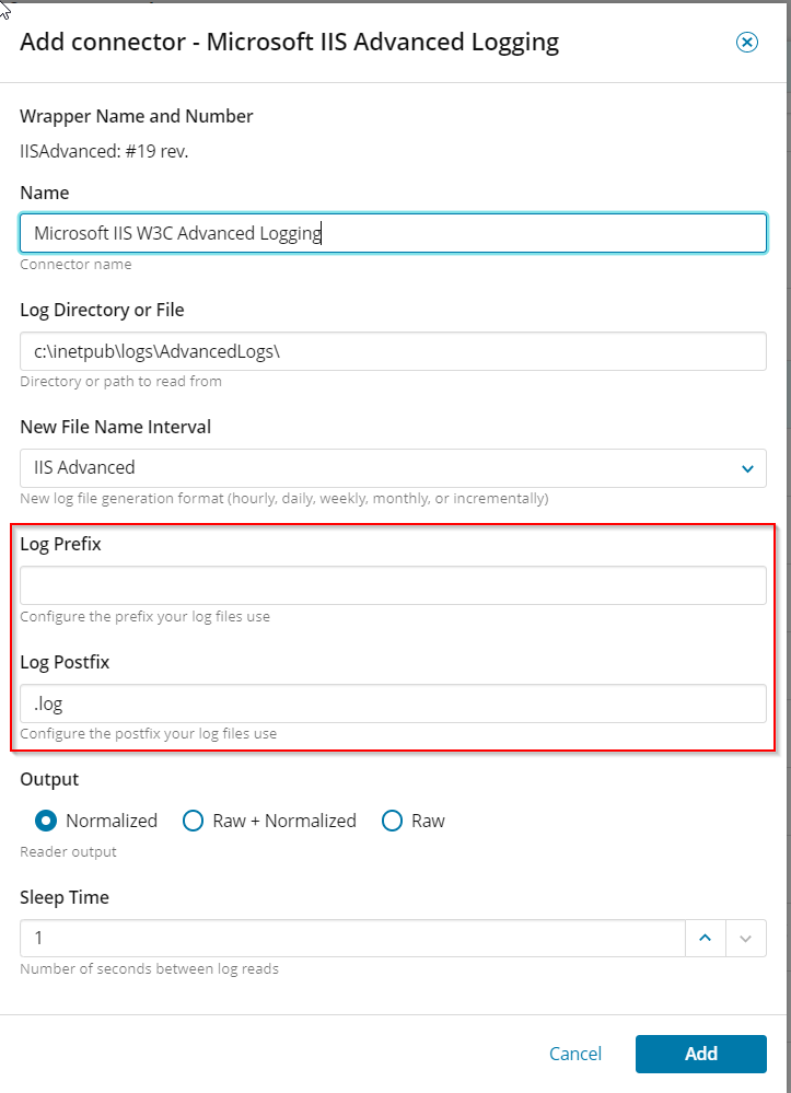

  4. Set the correct prefix and postfix for the log files in that location: Make sure to look at the log file on the node.

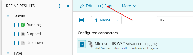

  5. Save the Connector and Start it:

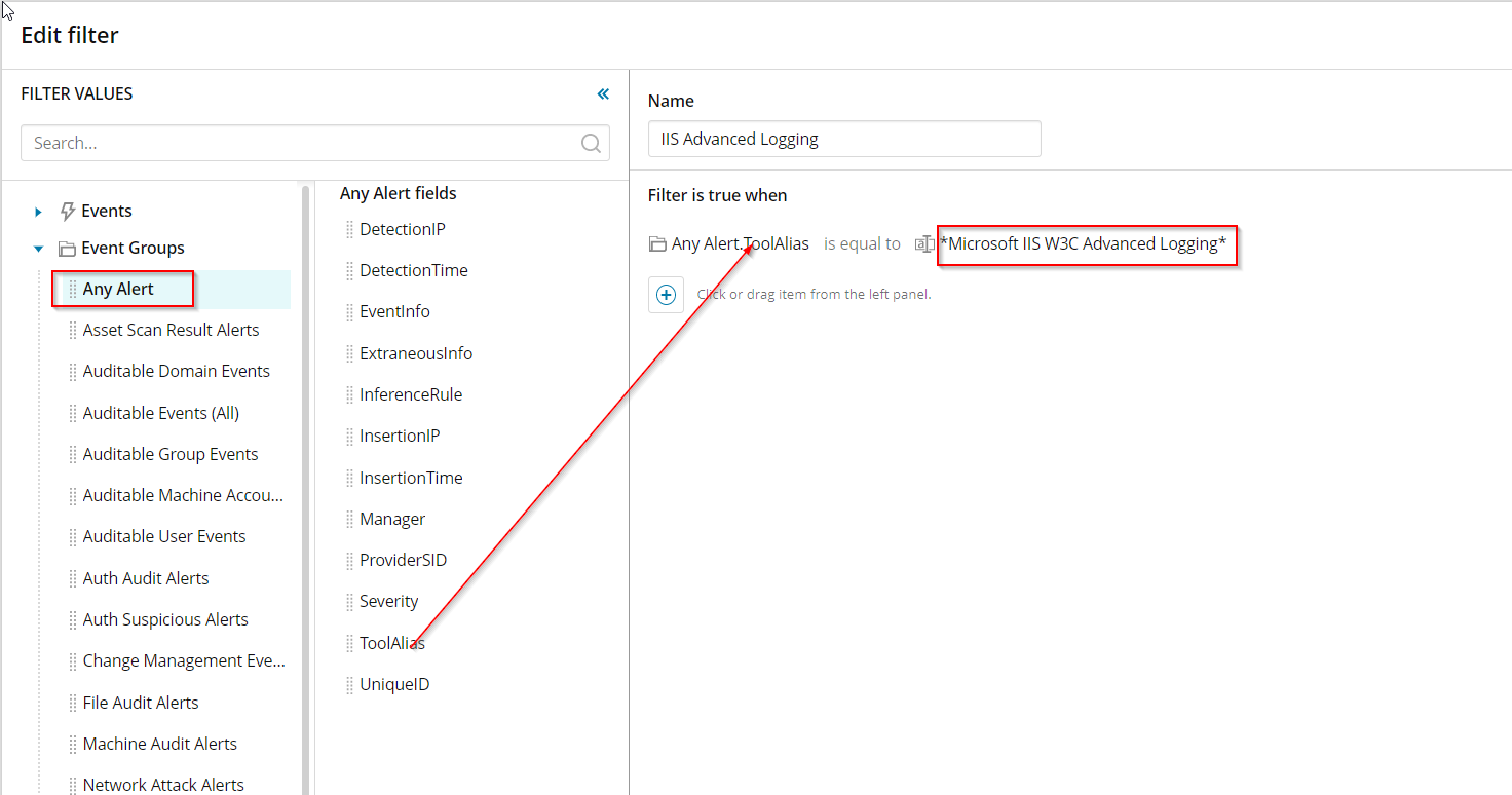

  1. Create a Filter in the Live Events > Filters area of the SEM Web Console watch the incoming data using AnyAlert.ToolAlias=*Microsoft IIS W3C Advanced Logging* (make sure to modify the name if you changed the alias on the connector) and save the Filter:
  2. If you are seeing data the IIS logging has started. If not, you will need to check the following items in IIS.

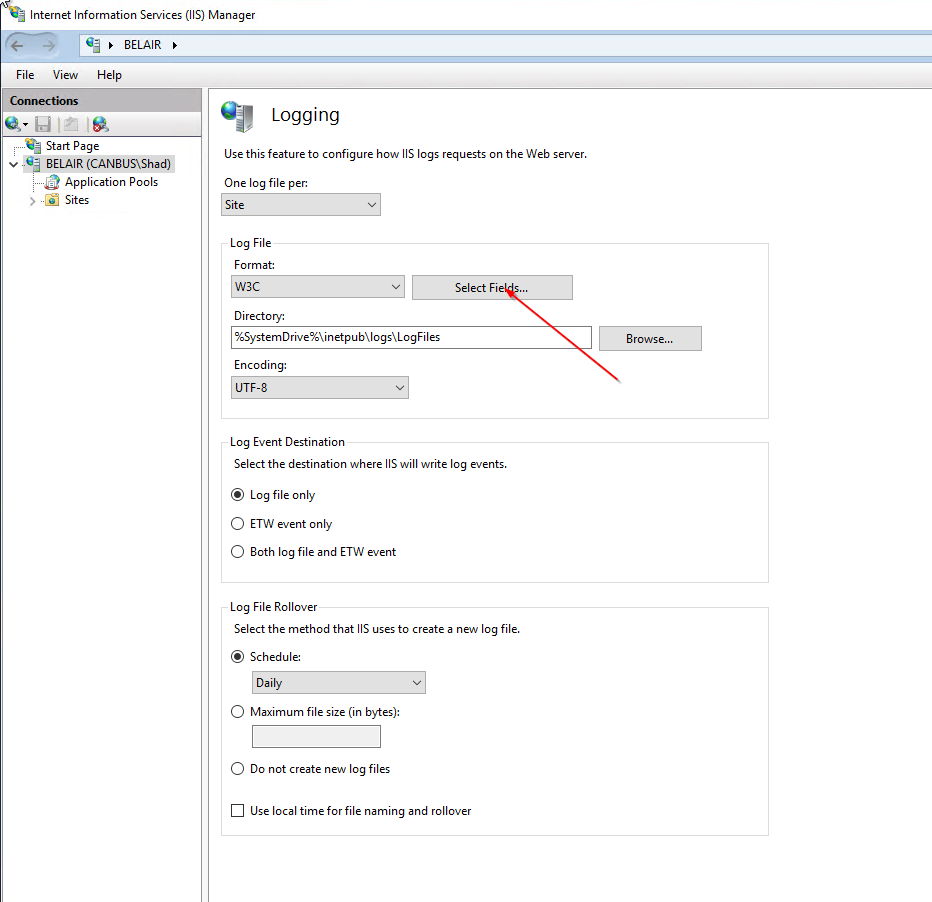

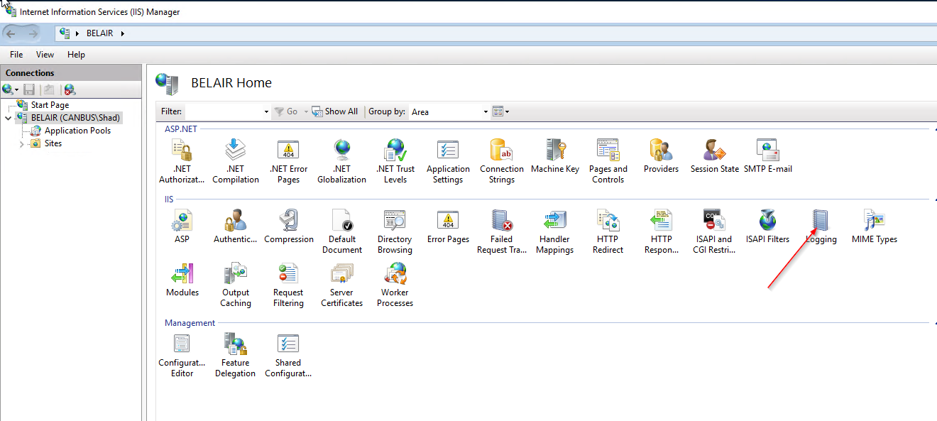

  1. Open IIS and select the Logging:
  2. On the Logging page click on the [Select Fields...] button to open the Select Logging Fields page:

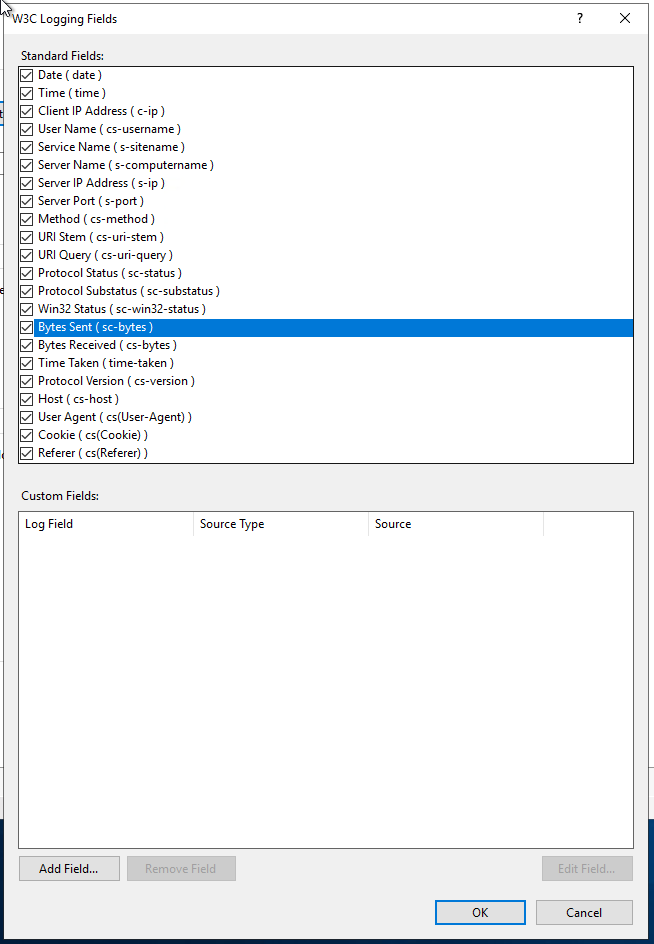

  3. Make sure to select all the items are checked on the Select Logging Fields page:
  4. Apply the settings and restart IIS and the logging should start to come in after a few minutes.
Note: If X-Forward Log field is not showing up in LEM web console, then make sure the "Microsoft IIS Web Server 5.0 (W3C Extended file format)"
