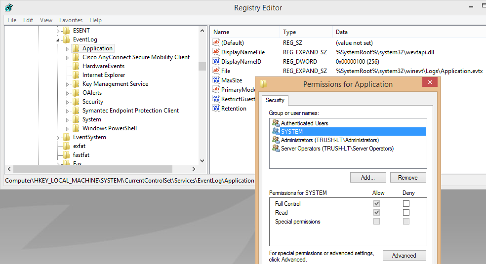

SEM Agent must have access to the Windows Event Log
SEM Agent uses the SYSTEM account to read the Windows event logs. Group policies (or local policies, or registry changes) can restrict access to any Windows Event Log.
Note the error message when accessing the event log with your login "...access denied...". This confirms that your user account does not have access to the event log, but we also need to verify that the SEM agent (which uses the SYSTEM account) has the access to read the event log.
The regedit image below shows the Application log being selected, but you can also see the Security and System 'log lines' under the "EventLog" in the registry. The registry access to this is located at: HKEY_LOCAL_MACHINE\SYSTEM\CurrentControlSet\Services\EventLog
Perform these steps:
- Open regedit.exe as an administrator.
- Navigate to HKEY_LOCAL_MACHINE\SYSTEM\CurrentControlSet\Services\EventLog\Application.
- Right-click Application, and then choose Permissions.
- Click Advanced, and then click Add.
- Click the "Select a principal" hyperlink.
- Click Locations to change focus from the domain/forest to the computer/server.
- Click Object Types to make sure that the "Other objects" category is checked.
- In the Name field, type NT SERVICE\EventLog, click Check Names, and then click OK.
- Ensure the following options are checked (under Show Advanced Permissions): Query Value, Enumerate Subkeys, Notify and Read Control.
Since the SEM agent uses the Windows SYSTEM account, be sure this user has the permissions.
Otherwise you may need to use a "domain admin" service account for the Agent service, and be sure the user (service account) has logon-as-a-service right.
