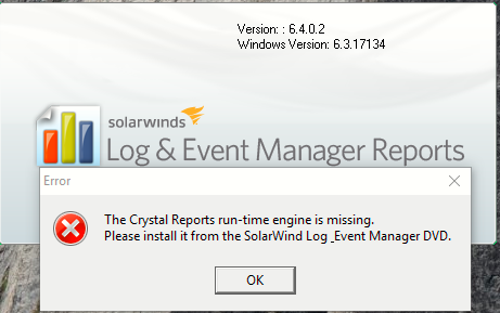

The following error message appears when you launch SEM reports console application either using the bundle or individual installers for Crystal runtime and reports.
"The Crystal Report run-time engine is missing"

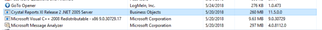

Your workstation/laptop has different version of crystal runtime as shown below.
The error may show up if you don't have the above version of crystal runtime installed. In this case, you might see an error like:

- Crystal Reports XI Release 2.NET 2005 Server package already installed
- error 1325 <username> is not a valid short File Name
- Uninstall (see Reinstalling the SEM Reports Console) the conflicting package
