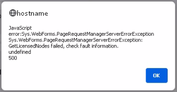

When trying to edit or add a node to the SolarWinds Platform, the following error message may appear:
JavaScript enonSys.WebForms.PageRequestManagerServerErrortixception Sys.WebForms.PageRequestManagerServerErrorException: GetLicensedNodes failed, check fault information.
undefined 500. Cannot edit nodes. Unable to edit nodes.
Example screenshot:
