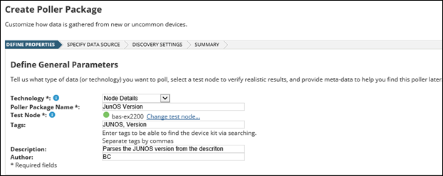

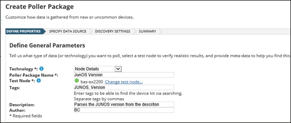

  3. Define the general parameters:
    For the JUNOS poller, I want to use Node Details
    Name the poller
    Select a test node
    Set Tags for searching
    Give a Description
    And Author
  4. Click Next on the bottom right.

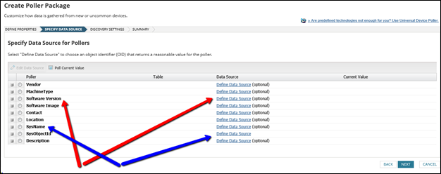

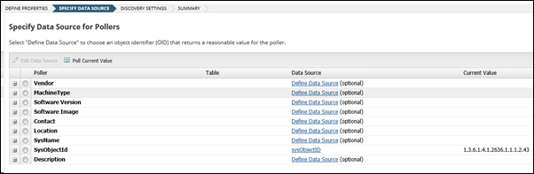

    We are going to concentrate on the two Primary fields needed to get the OS and define the Data Source.

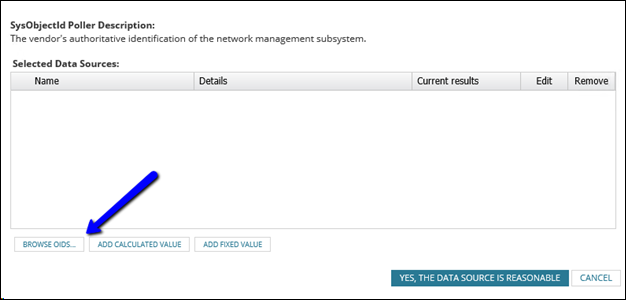

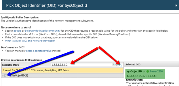

  5. Start by adding the system OID.
    a. Click Define Data Source.
    b. Click Cancel if the Use a Constant Value pops up.
    c. Click Browse OIDs.
    The OID for this for an RFC Compliant Device is 1.3.6.1.2.1.1.2.
    d. Put it in the Search bar, press the Magnifying glass to start the search.
  6. Select the box next to the sysobjectID(2) and the results will appear on the right if it is supported by the device.
  7. Click Submit.
  8. Go back to the Data Source for SysobjectID.
  9. Mark the radio button for the SysobjectID and click, “Yes, the data source is reasonable” to add to the poller.
    Now the system Object for the device is displayed to the right and the Data Source is listed:

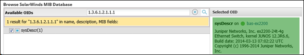

  1. Query the sysDescr OID 1.3.6.1.2.1.1.1.
  2. Use a Regular Expression to pull just the JUNOS.
  3. Use the same approach as above to define the data source but use 1.3.6.1.2.1.1.1.
    You will get something like this as a return:
    If you click Yes this is reasonable, you will get this:

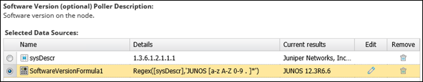

    This may not be reasonable for your needs and you just need the JUNOS 12.3.3R6.6.

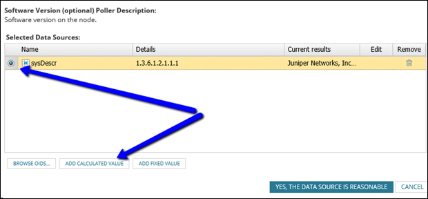

  4. Go back to the Data Source for software version.

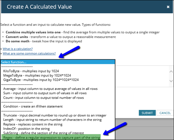

  5. Select the SysDescr line and click Add Calculated Value.
  6. Select the function of RegEx.

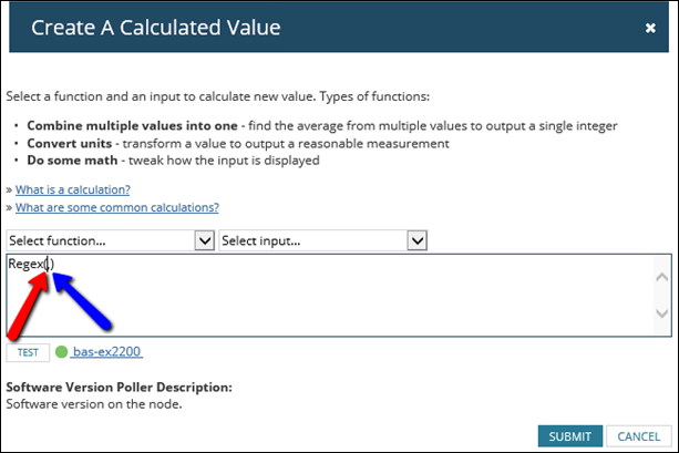

    This will bring up:
    Note the two arrows.
    The RegEx formula is encapsulated in the (,). Inside the (,) the coma separates the Input and the Regular Expression.
  7. Select the in by placing the cursor to the left of the coma in the parentheses and click the select input.
    Like this:
    Not all devices are going to have the same JUNOS versions, but it will show that they have the same format in the description.
  8. To work around many different combinations of letters and number and a dot(.) I came up with this JUNOS [a-z A-Z 0-9 . ]* so this will match and sequence of number and letters + the dot that follows JUNOS.
    And will get a return of:
  9. Add this and see the result:

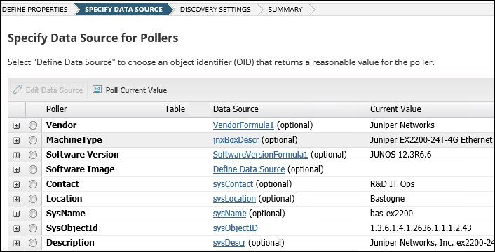

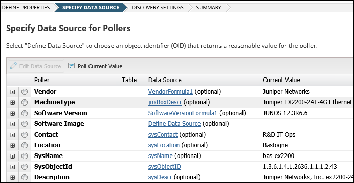

  13. Once this is created, go back and add more values and the page will look like the following:
  • First the ones that can be derived straight from the RFC 1213 MIB
    • Contact - 1.3.6.1.2.1.1.4
    • Location - 1.3.6.1.2.1.1.6
    • SysName- 1.3.6.1.2.1.1.5
    • Description- 1.3.6.1.2.1.1.1
  • Machine type - I am using the Juniper OID of 1.3.6.1.4.1.2636.3.1.2

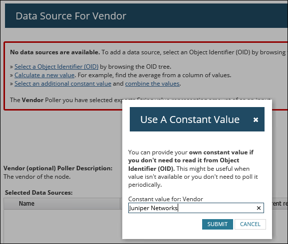

  • Vendor - Since this is based on Juniper already, one can directly add the "Juniper Networks" or parse it out of the Description like we did with Software Version earlier.  In this case the Vendor will always be Juniper
There, now it should be all completed with the exception of Software image and I found no information in this.

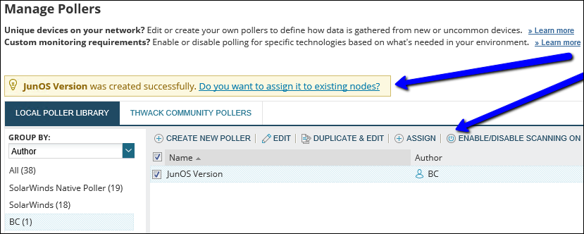

Assign the Poller to a Node
  1. Once the process of creating has been completed, the web page will return to the Manage Pollers page.

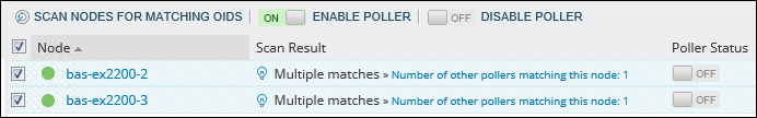

  2. Select the poller created and click Assign or click the link above in the Dialogue box stating: Do you want to assign it to existing nodes?
    The selection should be based on the vendor. Do a scan and the result will be similar to the following:
  3. Enable the Poller.
  4. After the devices poll, the information should be updated.
Note: For the ones that did not update, you will need to select the list resources. Once it completes, submit it and the device should update on the poll.
