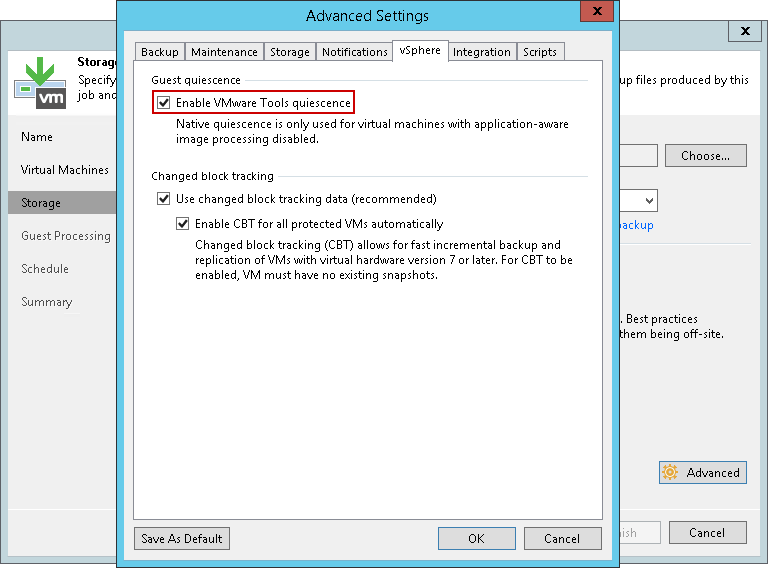

  1. In the Storage section of the backup job's wizard, click Advanced.
  2. Go to the vSphere tab and select the Enable VMware Tools quiescence check box.
For more information, see VMware Tools Quiescence.
