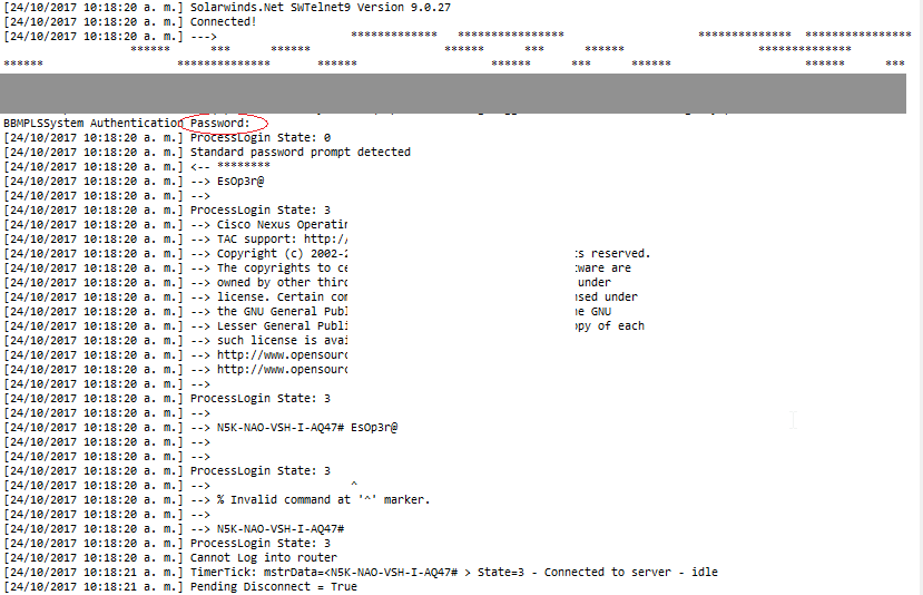

3. Banner contains a password
If your banner includes a Password: (like on the example below) then change your banner and remove it.
