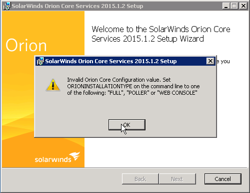

Invalid Orion Core Configuration value
If you attempt to run CoreInstaller.msi as a normal executable, you will receive the following error message: Invalid Orion Core Configuration value. Set ORIONINSTALLATIONTYPE on the command line to one of the following: "FULL", "POLLER" or "WEB CONSOLE"
11/29/2018 10:33 PM
8/11/2021 1:02 PM

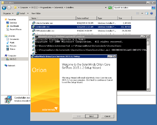

To use CoreInstaller.msi, you must run the file from a command line with a switch to indicate how the MSI package should run.
  1. Run Windows PowerShell as Administrator.
  2. Navigate to the installation directory. If the program is installed in the default location, enter:

    cd C:\ProgramData\Solarwinds\Installers
  3. Run the following command with the appropriate switch:

    CoreInstaller.msi ORIONINSTALLATIONTYPE=[FULL/POLLER/WEB CONSOLE]
  • FULL installs a complete Primary Polling Engine.
  • POLLER installs an Additional Polling Engine.
  • WEB CONSOLE installs an Additional Web Server.
Example:

C:\ProgramData\Solarwinds\Installers>./'CORE-2020.2.65120.50103-CoreInstaller.msi' ORIONINSTALLATIONTYPE=FULL

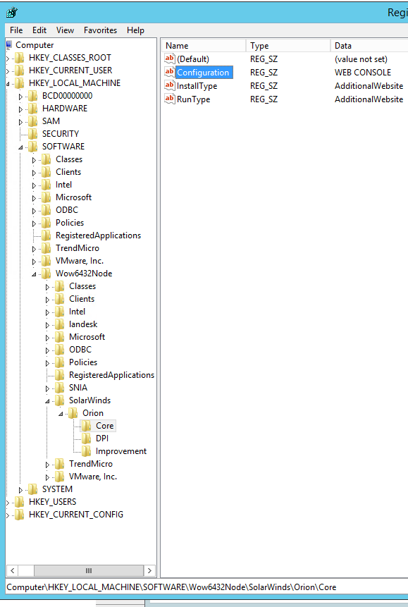

Other Possible Resolution:
Config wizard fails with: Method not found: 'Void SolarWinds.Orion.Core.Database.Account.set_AllowMapManagement
NPM 12.1 / SAM 6.4
Change or add registry below:
HKLM\SOFTWARE\WOW6432Node\SolarWinds\Orion\Core\Configuration
Change Configuration value to WEB CONSOLE
Add Key: InstallType AdditionalWebsite
Add key: RunType AddionalWebsite
