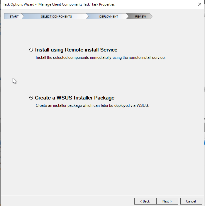

You can create a WMI Providers WSUS installer package.

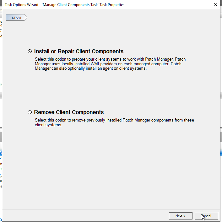

1. Click on the WSUS Name on the left panel.
2 In the right actions panel click on deploy client components.

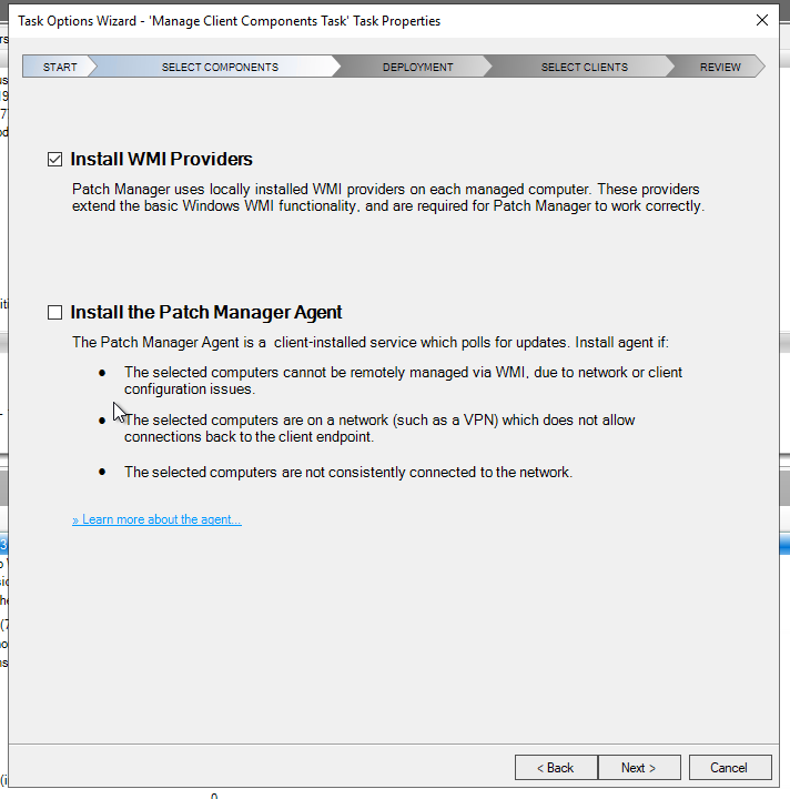

3. install and repair client components.
4. Install WMI providers
5 Create a WSUS installer package
6. Click Finish.

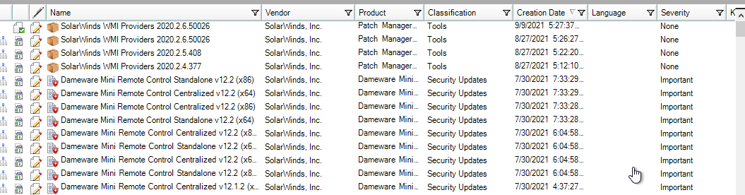

Publish the newly created WMI providers package.
1. Expand Administration and Reporting.
2 Expand Software publishing>SolarWinds Inc. Packages.
4 Publish the SolarWinds WMI providers
