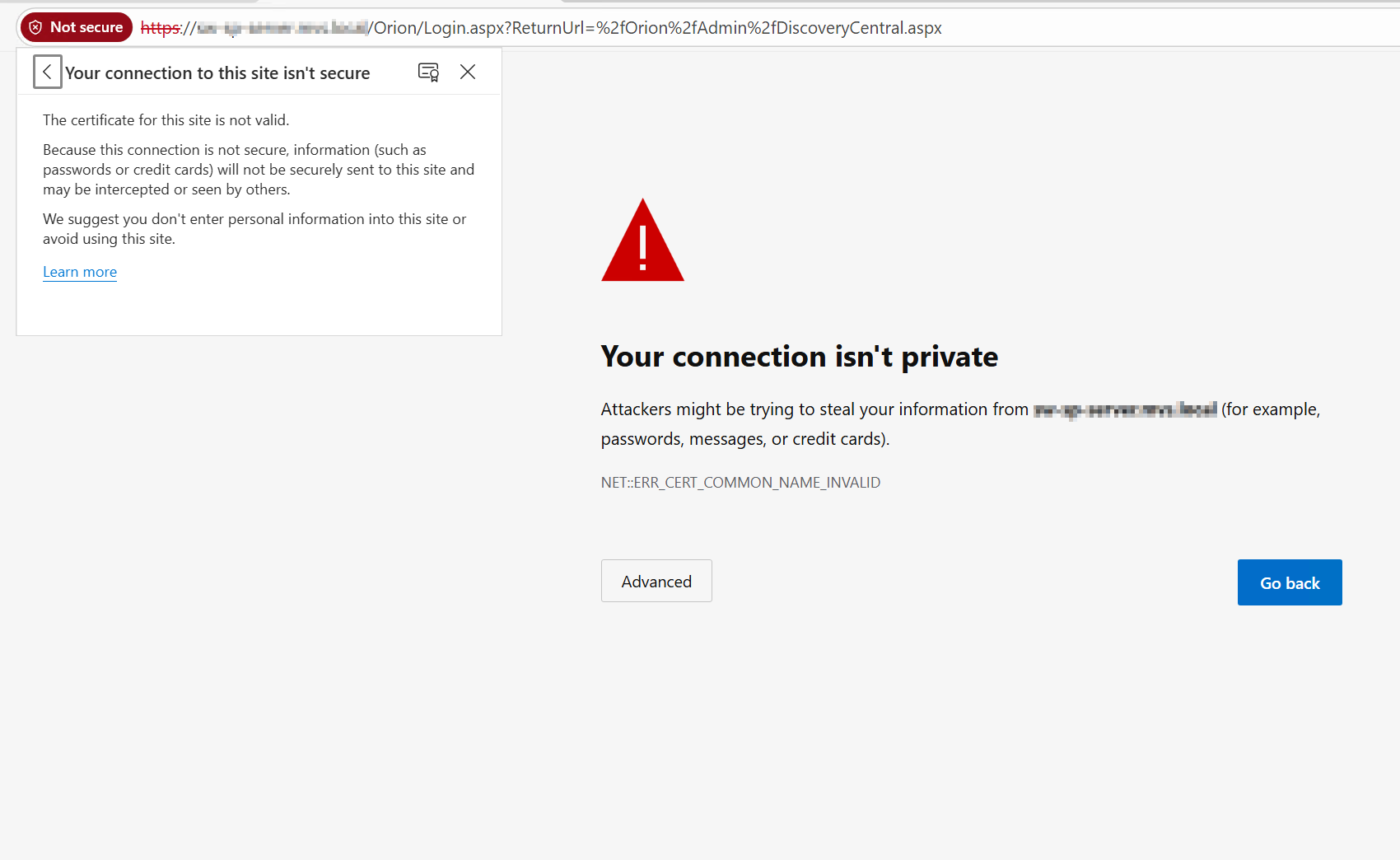

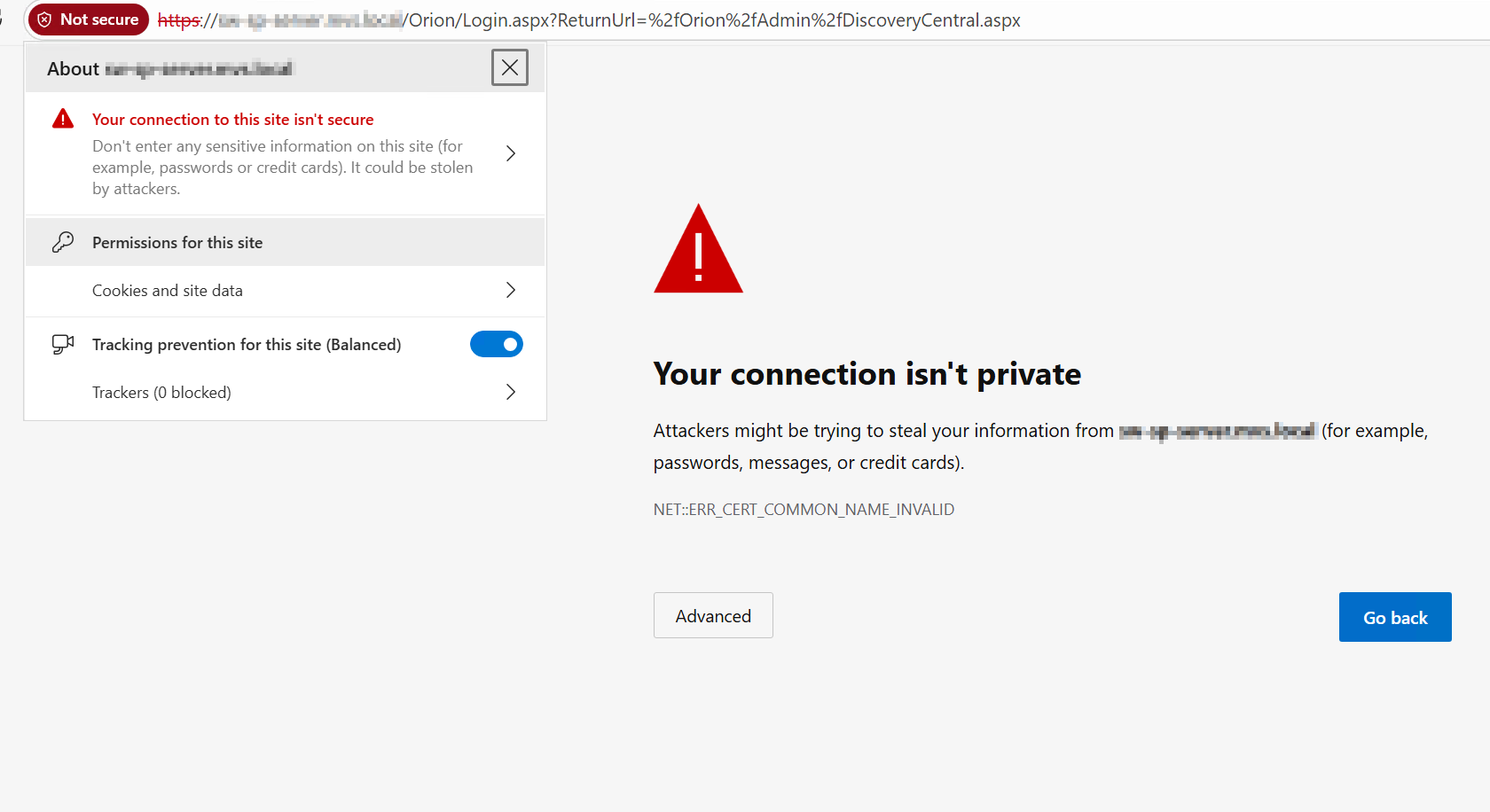

Internal CA Certificate not selectable in Configuration Wizard and browser shows Connection Not Secure in the SolarWinds Platform
You may successfully bind an internally issued CA certificate in IIS for the SolarWinds Web Console, yet still see browser warnings indicating the connection is not secure and find that the certificate is not selectable in the SolarWinds Configuration Wizard.

What you’re seeing from the browser is expected until your internal CA is trusted on the client side. What you’re seeing from SolarWinds Configuration Wizard (only self‑signed cert available) is also expected, because SolarWinds filters out many “valid in IIS” certs and shows only those that meet its own criteria.
  • Browser warning about your internal CA:
    Normal until the CA chain is correctly trusted and hostname/SANs are consistent.
  • Configuration Wizard only offering the self‑signed “SolarWinds‑Orion” certificate:
    Also normal if:
    • Your internal CA cert is not fully trusted (chain, CRL, EKU, etc.), or
    • There’s any validation issue. CW will hide it, while IIS still allows it.
