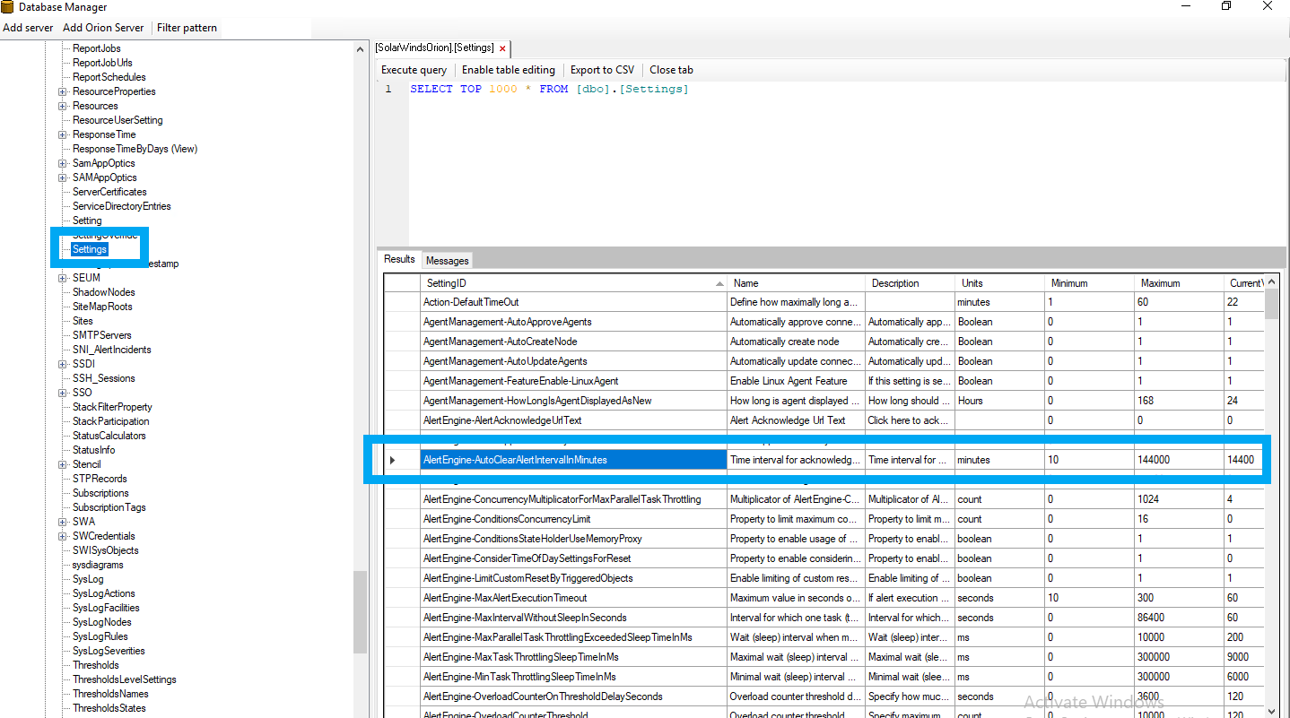

In newer versions of NPM this setting has been moved to the database in the settings table: -AlertEngine-AutoClearAlertIntervalInMinutes
