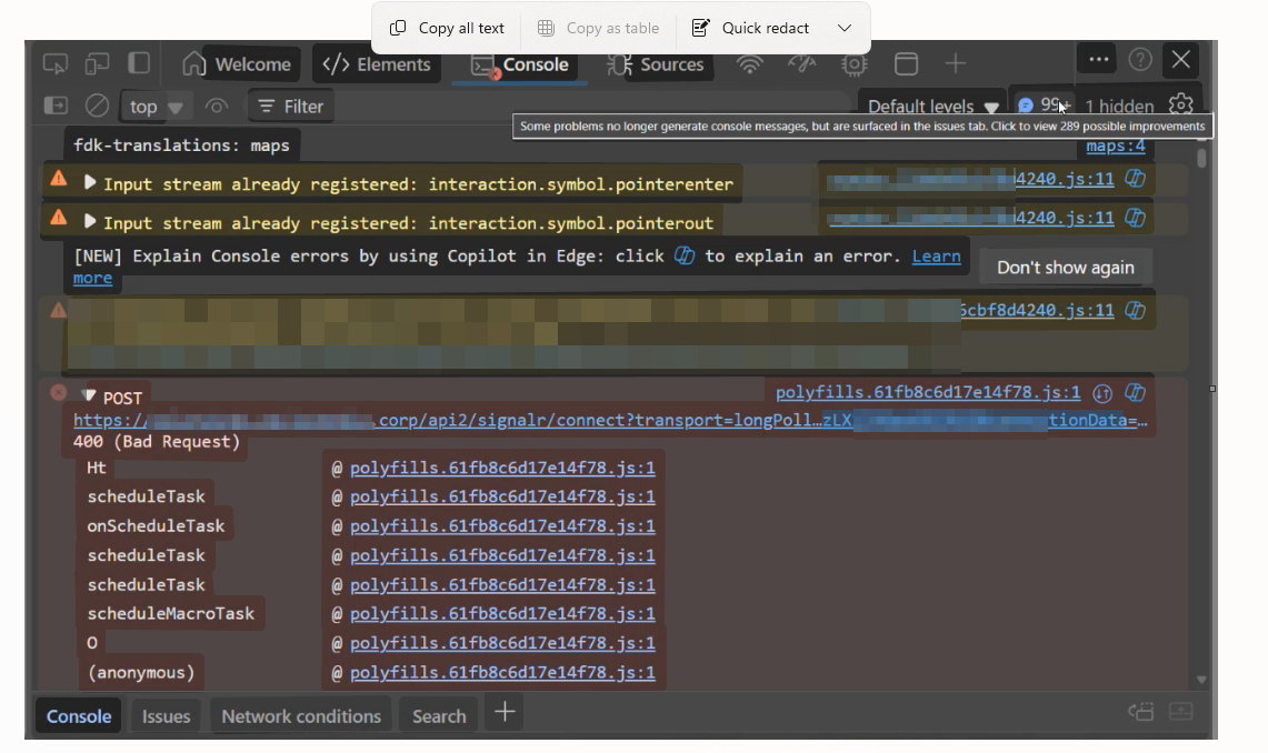

Initial investigation involves checking browser behavior to determine whether there are underlying request or connectivity issues impacting the Intelligent Map feature.
To investigate, use Microsoft Edge or Google Chrome to access the browser’s developer tools. Look for requests to the following URL that do not end in HTTP 200 status:
http(s)://orionurl.com/api2/signalR/
A 400 Bad Request error may indicate the underlying problem.

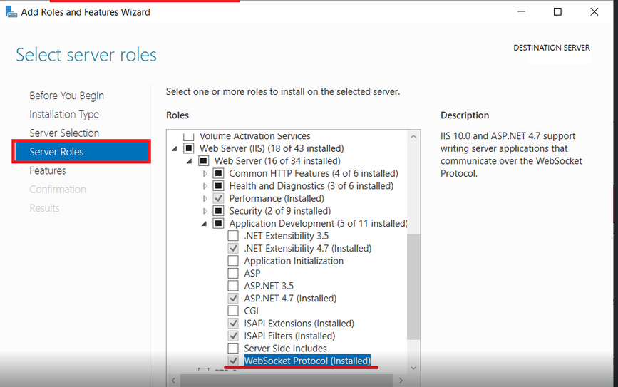

Ensure that the "Web Socket Protocol" feature is installed on the server and confirm whether this option is presented when running the Configuration Wizard.
Please follow these steps:
  1. Create a snapshot, so you can revert in case of any issues.
  2. On the SolarWinds server, open Server Manager.
  3. Click "Add roles and features"
  4. When on "Server Roles" step, in "Roles" section navigate to Web Server (IIS) > Application Development > Websocket Protocol.
  5. Enable "WebSocket Protocol" option:
  1. Press Next and then press Install (server restart is not needed).

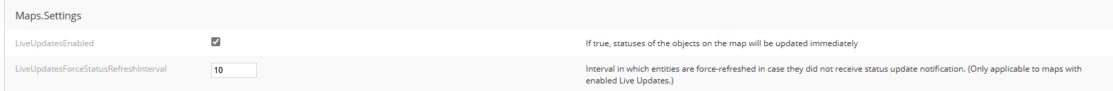

  2. Enable Live updates in the SolarWinds Platform Web Console:
    1. visit https://<OrionUrl>/Orion/admin/advancedconfiguration/global.aspx
  3. Search for LiveUpdatesEnabled
    under Maps.Settings, check LiveUpdatesEnabled
  1. Click on Save, and check if there are any pending requests or another load issues.
If the issue persists, disable Live Updates. This will stop real-time map updates but will prevent the connection issues and allow the maps to load correctly.
