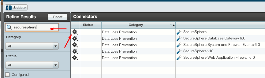

  3. Search for SecureSphere to filter the results as shown below. Click the gear icon for the type of SecureSphere device logs you want to monitor.

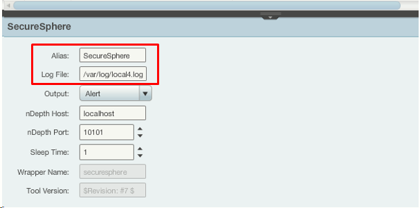

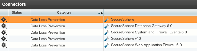

  4. In this example we will select the first connector, and then click the gear icon to create new connector which brings up the new connector details pane.
  5. Ensure the log file path highlighted above is correct and matches what is configured on the SecureSphere Data Loss Prevention console and leave other settings untouched. Optionally, you can change the Alias name if you want to.
  6. Once you are satisfied with the connector configuration, click Save at the top right to save the changes. The new connector is created and is in the stopped state as shown below.

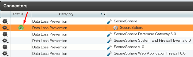

  7. Click the gear icon besides the newly created connector, and then click start to start the collector, which should look like this:

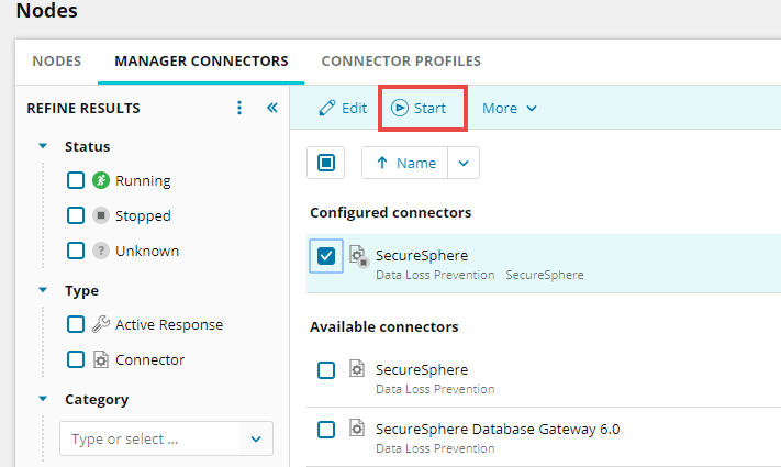

  1. In the SEM Events Console, navigate to Nodes > Manager Connectors.
  2. In the search box, enter SecureSphere.
  3. Select the SecureSphere Data Loss Prevention connector, and then click Add Connector.
  4. Ensure the log file path is correct, and matches what is configured in the SecureSphere Data Loss Prevention console. Optionally, you can change the name.
  5. Click Add.
  6. Under Configured connectors, select the connector, and then click Start.
