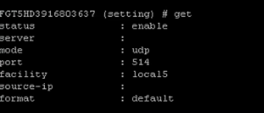

Firewalls running FortiOS 5.x
In FortiOS 5.x, you can only define a syslog server using a command line. If you defined virtual domains (VDOMs), run through the appropriate command for each VDOM.
The system includes three sets of syslog settings you need to consider before conducting an overwrite. SolarWinds recommends identifying these settings first before you continue.
config log {syslogd | syslogd2 | syslogd3} setting
show
end

To configure your firewall running FortiOS 5.x, open a command line and execute the following:
config global
config log syslogd2 setting
set status enable
set csv disable
set server <sem><sem/></sem>
set source-ip <ip><ip/></ip>
end
See the FortiGate FortiOS CLI Reference for FortiOS 5.0 Guide for more information.
