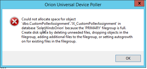

The following errors can be seen within the Configuration Wizard Logs or during the process of running the program.
Insufficient disk space in filegroup 'Primary'
System.Data.SqlClient.SqlException (0x80131904): Could not allocate space for object '[dbo.Table]'.'[IX_ColumnName]' in database '[DatabaseName]' because the 'PRIMARY' filegroup is full. Create disk space by deleting unneeded files, dropping objects in the filegroup, adding additional files to the filegroup, or setting autogrowth on for existing files in the filegroup.
e.g.
This is also true if you see in the logs anything like this:
...the 'PRIMARY' filegroup is full. Create disk space by deleting unneeded files, dropping objects in the filegroup, adding additional files to the filegroup, or setting autogrowth on for existing files in the filegroup
Error is not limited to the 'Primary' filegroup as it could be the 'TIMESERIES' filegroup as well
