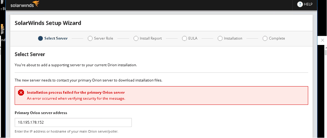

This article details a resolution to the following error received when trying to install an additional poller on a clean VM:
Installation process failed for the primary Orion server. An error occurred when verifying security for the message
You may see following error in Installer logs.
2018-02-27 14:49:51,653 [16] ERROR (null) SolarWinds.Administration.Installer.ErrorHandler.HttpResponseAdapter - Unexpected error occured.
System.ServiceModel.Security.MessageSecurityException: An unsecured or incorrectly secured fault was received from the other party. See the inner FaultException for the fault code and detail. ---> System.ServiceModel.FaultException: An error occurred when verifying security for the message.
   at System.ServiceModel.Channels.SecurityChannelFactory`1.SecurityRequestChannel.ProcessReply(Message reply, SecurityProtocolCorrelationState correlationState, TimeSpan timeout)
   at System.ServiceModel.Channels.SecurityChannelFactory`1.SecurityRequestChannel.Request(Message message, TimeSpan timeout)
   at System.ServiceModel.Security.SecuritySessionSecurityTokenProvider.DoOperation(SecuritySessionOperation operation, EndpointAddress target, Uri via, SecurityToken currentToken, TimeSpan timeout)
Orion Platform
  • This is likely the result of a wrong time zone on one of the pollers
  1. Verify that the date, time, and time zones match on the database server, main polling engine, and additional polling engine.
  2. Reboot the servers that required a change in time zone settings.
  3. If using a domain account, use a local Orion account instead. Go to the Web console > Settings > All Settings > Polling Engines > Download installer. Right click properties on installer > unblock and Rerun the installer as admin
