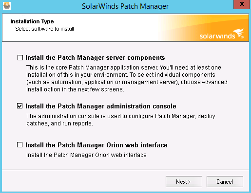

  7. Run the installer.
  8. In the Installation Type screen, select Install the Patch Manager administration console and clear all remaining selections.
  9. When prompted, select a location.
  10. Complete the Wizard.
